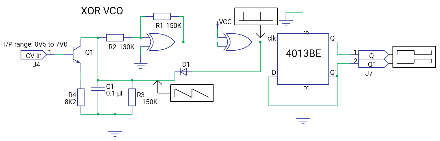

I have augmented the post #14 circuit to make a VCO ( it works, I built it ! )
By adding a monostable in place of the toggle flipflop a variable PWM circuit could be made though it would also have variable frequency, which may or may not be a problem depending on what you use it for.

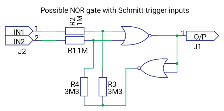

Idea for Schmitt input NOR gate:
If I set one input to 2.5V and sweep the other between 0 and 5V, I do not get any change in the output.
What are the rules for a two-input schmitt trigger? Is this an adjusted test?
On the other hand, I set one input to triangle wave at 10 Hz and a second triangle wave at 9 Hz. No output signal change.
I cannot imagine a situation where such a device would be needed, other than for completeness of a set for those of us who have OCD.

Referring again to the 74HC002 (not the 74HC02)...
I could not find one either. I never purchased one myself either at any time in the past, just read about them.
