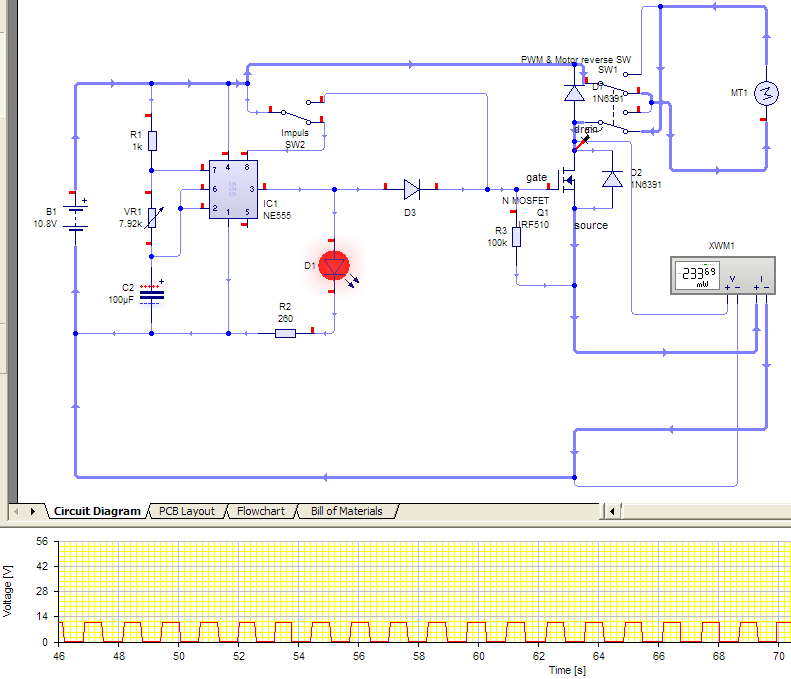

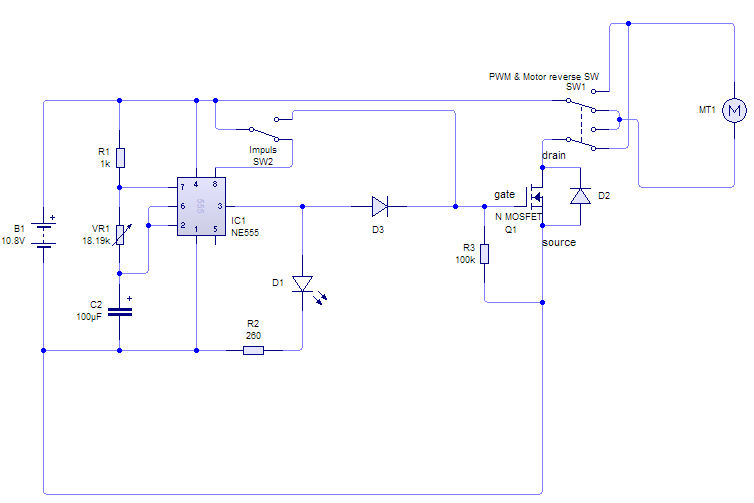

Any schematic ?, sorry I'm rather hard to understand. I have made this other schematic myself by googling some MOSFET motor control examples and 555 timer circuit. However my simulator just blows everything up ;/ could somebody simulate this?
Seems like missed the diode A7 before the PWM switch, back EMF was causing voltage spikes up to 45V and that was the problem, now seems simulate fine. Could you debug it further, I would not want to damage anything.
What mosfet I need? I know I need Resistance Rds(on) lowest possible with enought Amps and perhaps 40V to be safe?
