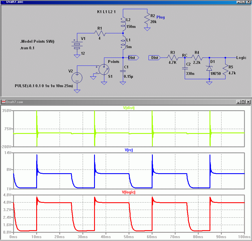

I've got a VM110 USB Experiment Interface Board to play around with, which takes external inputs, and via the USB, brings them into the world of software.
What I'd like to do is take the 12v pulse from the coil (negative) in my classic mini, and use the USB board to read the pulse in... for a RPM reading.
Now this USB interface has a few inputs. basically you get a 1 when INPUT 1 is connected to the GND, and 0 when it's not, same goes for INPUT2 - GND, etc...
So, I thought i'd need some sort of relay that trigger's the on/off state.
I think the RPM pulse could be upto 200 pulses per second, Am i right in thinking normal car relays are too slow? I'm more computers than electronics so i'm not 100% sure what to do?
hope someone can help,
much appreciated
Jon.
Jon, this will work but you want to stay away from the coil signal. There are some really nasty transient voltage excursions (+_250V?) across the primary. If you have a storage scope with a 10X probe, go look and you will see what I mean. It will take a fairly complicated network with R,C, and Zener clamping diodes to clean it up to where you can feed it into 5V logic. Using a pulse transformer with two windings is a good idea to eliminate common-mode ground noise if you must use the voltage across the coil as the source of your signal.
If you dont have access to a scope, follow the wire which switches the coil. It usually is done by a big switching transistor (Bipolar or FET) in a Coil Trigger Module. Try to locate the signal that triggers this module. It usually comes directly from the ECU and is a "logic" signal. A wiring diagram and a scope is the best way to look at this...

Hi Mike,
I'm afraid you lost me at storage scope. :(
"scope" is an Oscilloscope.
Storage scope is one which can store relatively slowly varying events for subsequent viewing. At idle speed, ignition signals in a normal car happen just slowly enough to make them hard to view with a conventional o'scope.
Ok, I did this once. It seems I used a network sort of like this:
The zener is 4.7V.
