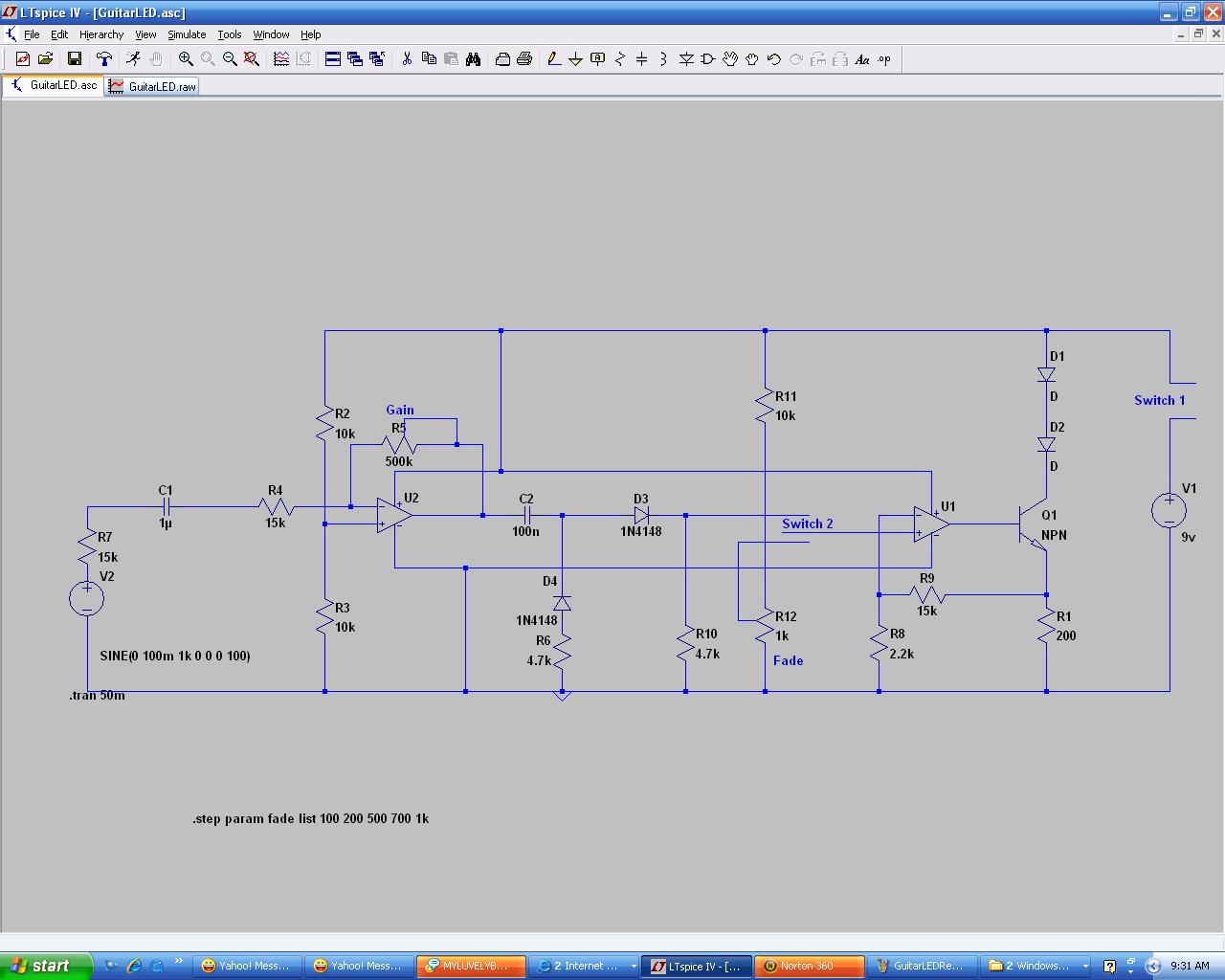

Your second opamp might be destroyed by the AC signal (its negaive voltage) at its input since it does not have a negative supply voltage.
If your second opamp is inverting then it won't have this problem. I guess an LM358 single-supply dual opamp could be used.

Good point. This was supposedly a working circuit which I added a couple components. We can modify the amp for inverting operation.

Now that I think about it, there are a couple problems with the circuit I drew. The fader circuit won't work like we want it to. I'll post a revised drawing soon.

Here is rev2. I made some changes for the pickup's hight output impedance. V2 and R7 are NOT part of the circuit, but intended to model the pickup for simulaion. The diodes between the two opamp's are intended to protect the 2nd amp from damaging voltage. They may not be needed if use use an LM358, but when I looked at the Fairchild datasheet, it said min input is 0V, so I suggest to just leave them in. ( others will disagree, I"m sure ) Any diodes that will switch at audio frequencies will do for D3 & D4. Switch 1 and 2 can be a 3-way switch, as long as the swtich has 3 seperate pairs of contacts, and is not a 3-to-1. Otherwise, switch 2 can be a spdt. Make sure you use good, medium performance op-amps. A 741 probably won't cut the mustard.

Change R12 to a 1k variable resistor. I'm still fooling with this. I'm updating the schematic to reflect this change.
PS: You won't get full range from the fader. Might need to reduce R11 slightly. I done fooling with this.

R1 should be 100 ohms, as in the original Musicator. Changing the value will change the brightness.

Hi BrownOut,
On your new schematic:
1) The first opamp is inverting with a 15k input impedance so it throws away half the input signal level. If it is non-inverting then it can have a high input impedance for a small signal loss.
2) The diodes will not be needed if the second opamp is an inverter since then its inputs will never go negative if its gain is 1.
AG makes some good points. But I'd say let's just leave it as it is for now.
