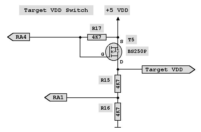

I've been experimenting with one of my Inchworms and added a Radio Shack Reed Relay across RA4 (16F877 pin 6) and +5 (with a 1N4148 kickback diode) Two trace cuts (4.7K 1% *near the TP+5) and the +5V on CON1. I'll publish photos and info if anyone else needs this mod.

The mod functions to disconnect the +5V from the target CON1 (ICD2). I've not tried it with the mclr & intrc clk enabled although MPLAB still warns me not to. The relay coil (20ma) connects between +5 and the 16F877 RA4 (pin 6). The contacts connect to +5, R3 (top) and CON1 (+5V). A small 1N4148 diode should be added across the coil contacts (cathode to +5).

A programmer really needs to switch the 5V supply to the target device, which the InchWorm currently doesn't do - this restricts the config fuse options in devices like the 16F628 - where you can disable the MCLR pin and use it as I/O.
The ICD2 software already includes this facility, but it wasn't implemented in the InchWorm hardware.

If you shop around, you can find reed and/or DIP relays for more like $1-2. However, is there any reason you can't implement the same thing using a transistor, since you'll be changing the design anyway? I haven't delved into the details, but the USB ICD2 clone that I have just uses a PNP transistor to switch Vcc, according to the schematic.
Seems like an awful lot of trouble and expense when all you need is a P-channel MOSFET and a resistor (or a PNP transistor and two resistors)? Duh!!!
(the two analog voltage divider resistors in the pic' below should already be on the board though they're probably connected to a "hard" 5v signal)...

I'll look into the BS250P, you've posted it before I should learn to listen. I was concerned about the 230ma drive source be too small. Is there a 400ma pfet thats commonly available?
Thought #2 is use a PTC to limit current and remove the 7805 alltogether. So it's USB power plus RS232 (basic) and with the 18F4550 it's USB all the way.
