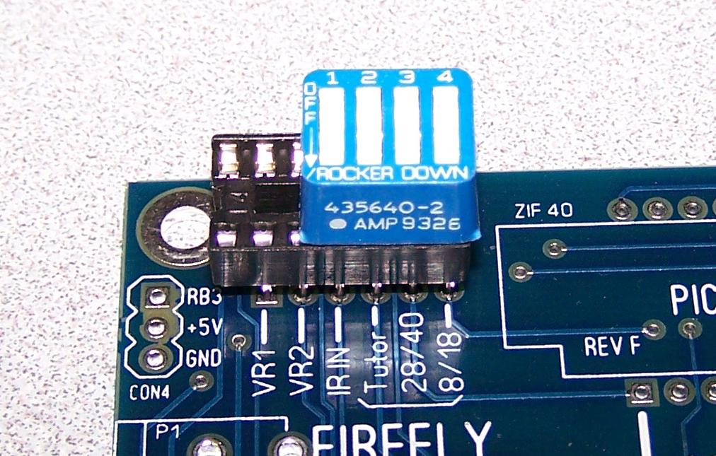

From what I can see, only SW5-5 and 6 are needed right? I only have a 4 position DIP switch on hand. I intend on using a 14 pin low profile IC socket with two of the pins cut off for SW5 and plugging in my 4 position DIP such that SW5-3 thru 6 are hooked up. The socket will intrude ever so slightly on the pad for the stand-off, but I don't forsee any problems with that. At least then I can change it to a six position if I decide to populate the rest of the board.

I would just tack solder a small link over the 40 or 18 link depending on which PIC I was going to start with. Easier than opening the holes later if you decide to build the "Fly" half when you get a 6 position DIP switch.
Opening what holes? I will just take the 4 postition DIP switch out of the IC socket and put in a 6 position DIP switch.;)
