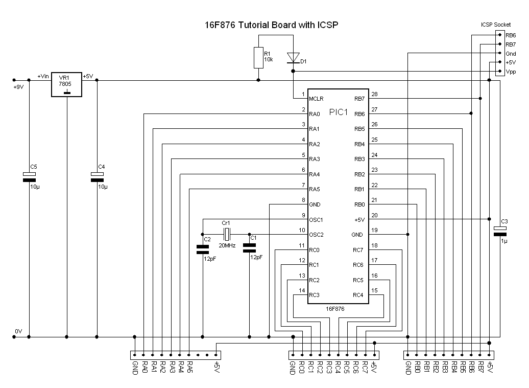

If I purchase kit #1, how would I be able to interface a PIC to program it? Is there a simple design that I can build to be able to use the programmer now? I'm new to PICs and just ordered the kit so I need a daughter board for the actual PIC.
If it's any help?, here's a version of my 16F876 tutorial board with an InchWorm ICD socket added.
Hmm.....forgive me as I am new to some of this. I've build simple electronics projects so the construction is not a problem but I want to ensure I haven't misunderstood anything. :D
Your schematic is for a simple programmer or a board I can connect to the Inchworm kit?
Again, forgive my confusion.
Only for programming 28 pin pin PIC's, different size PIC's use different pins, you need to wire a ZIF socket so it can take various PIC's in different positions - being careful not to place 13V on a pin you shouldn't!.
I'm not sure how to wire the ZIF so that I can use the different chip sizes so I guess I will wait for the Firefly companion board to be released. I think it will be easier to learn the programming on a less complex chip than a 28 pin, although I think I'll need the functions of one eventually.
John
I've studied the schematics for a bit and see how it's wired so I can make a pcb for the pic chip until the Firefly is available. Never study schematics until you've had at least two cups of coffee.

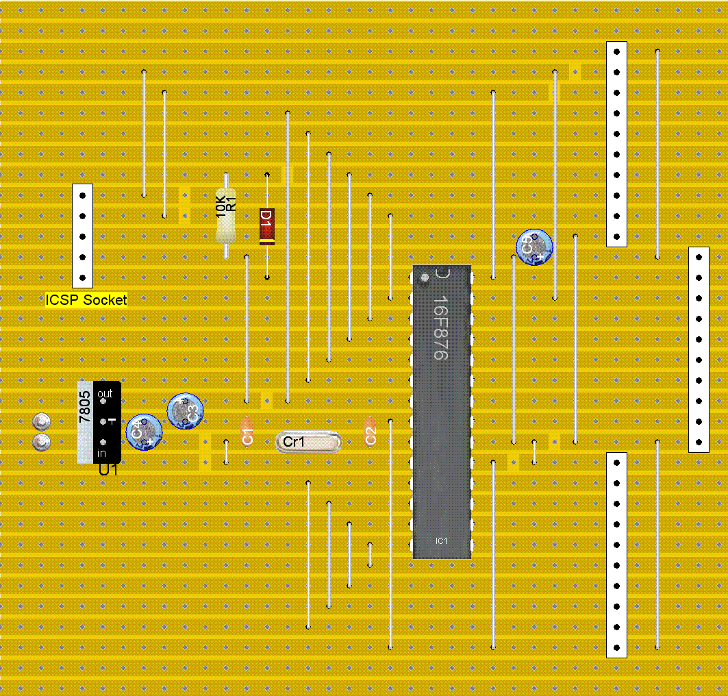

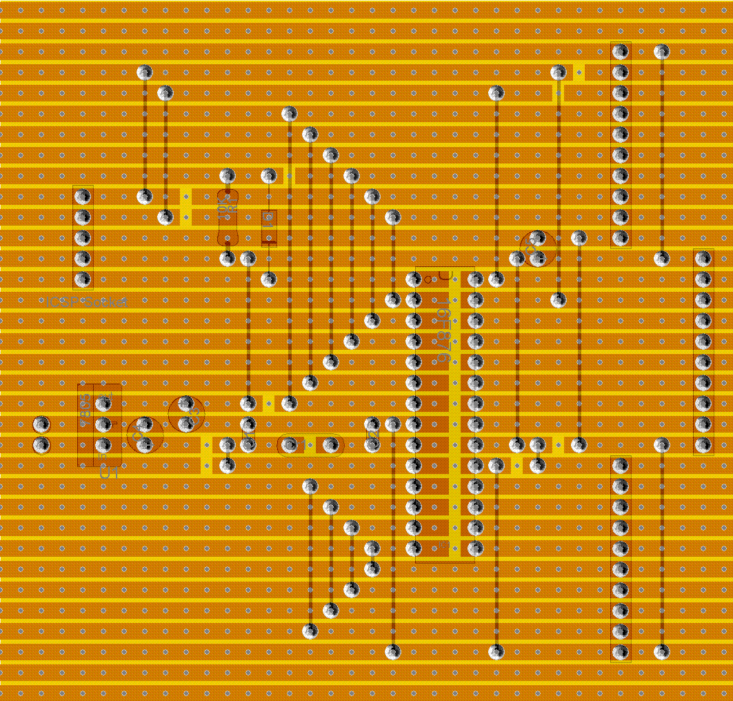

I can post a veroboard layout if that's any help to you?.
jduncan459 said:
That would be great. I'd appreciate it.
I've got a solderless breadboard here so I can work on it.
OK, here it is!.
