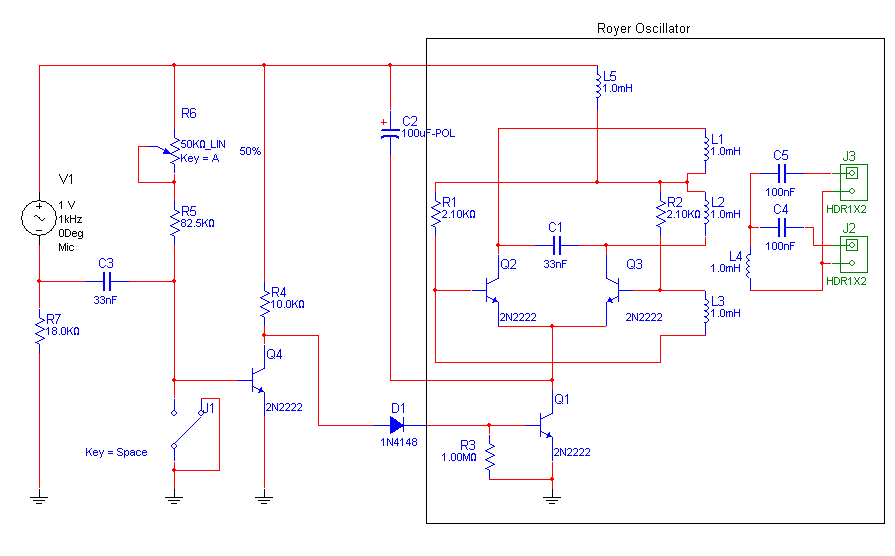

Is it possible to swap out caps or resistors to increase the gain of an inverter (flashes the cathodes based on sound)? Its made up of transistors, resistors, a pot, and capacitors, so what would I be looking for?

You would be looking to post the circuit, so we can see what you have!.
Will do. Give me an hour or so and Ill have it up.
EDIT. Sorry its crappy, its the best I can do. Ill grab the pot value in a sec.
EDIT 2. its 50k

I think he is trying to get it to flash at normal brightness but respond more to lower sound levels? You need to alter the gain of that first transistor amplifier the mic is connected to. It altered with the resistors surrounding it, but it is probably easier to use a vaiable gain op-amp amplifier in it's place to set it as you wish.

The inverter thats in the schematic has this feature already. I just want to turn the gain up on the amp thats connected to the mic (again, in the schematic). What resistor(s) would I be changing, and would they increase or decrease in value?

Does that schematic make sense? - I don't see any low-impedance connections between the transformer/L1 and the power supply.
What does is the pot supposed to do?

I tried to trace it out as well as possible, but there probably are some errors. Im more concerned about the amplifier portion though. The pot controls the sensitivity of the microphone, and the switch changes between solid-on and sound-activated.

The thing is that without having a clear schematic, any suggestions are going to be hit and miss. The inverter section should just involve 2 transistors. The other two transistors are hooked up in some way that isn't obvious - and it doesn't exactly help that the "schematic" (which is understandably cribbed from the layout) is drawn in an utterly backward manner...

I had to recreate it from the PCB. Being 16 I think thats pretty decent. If it would be easier, I can scan the PCB bottom and overlay the components on the top, but I wont be able to make a better schematic than that. Im also not aware of how the schematic is 'backwards'. Please explain. Thanks.
Generally schematics are drawn with inputs on the left, outputs on the right, minimize the number of overlapping components/lines, keep ground lines on the bottom, or just use ground symbols - it's just a way of keeping things readable. If you can post some reasonable pictures - have the camera facing the board flat on, put a camera on a tripod to minimize changes between repositioning to keep the image scaled properly, and just post the top side and bottom side, I can match up the images either using a image program or just manually eyeball it.

Well, since you took the time to take a photo of it: here's my interpretation:
I downloaded a copy of Electronics Workbench, so I was "learning" it as I went along - so the component values are likely botched up, but I'm pretty sure that this is the configuration. Obviously I'm completely guessing on the transistors, but from the circuit config, it's possible that they're all NPN's.
The thing that really helped out was finding stuff about the Royer oscillator - it's apparently a very common oscillator configuration.
So, given this schematic, what do you think happens when Q4 turns on?

Technically I scanned the board, but thanks nonetheless. So now with a proper schematic, which part would I change? Oh, and about Q4, I can honestly say I have no freakin' clue.
