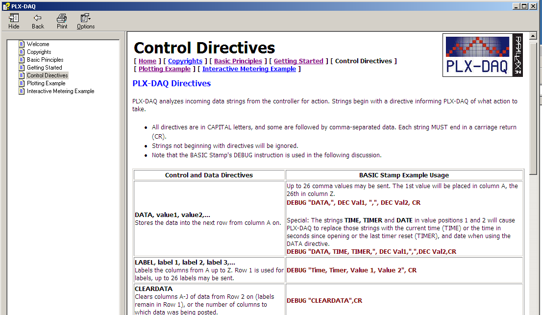

Here is the "DATA command" from my version of the PLX-DAQ help file, it talks about BASIC Stamp. I don't have a basic stamp.
The important thing to note is the column on the left "Control and Data Directives"
Look at the first command:
DATA, value1, value2,...
This is what your data source should send to the PC for PLX-DAQ to intercept it and write it into an Excel spreadsheet.

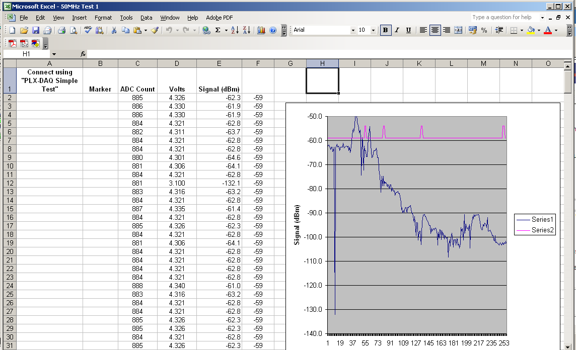

In the PC, it looks like this:
Notice that column A is empty (because of the first comma sent from the PIC)
The second column "Marker" is empty because I had not pressed the marker button yet.
Column C is the value from the ADC.
The rest of the information is processing which takes place in Excel.
The ADC value is converted into a voltage, that voltage is then converted into a signal level (in dBm).
The column with the -59 data is a way of displaying the marker on the graph, (the pink ish coloured trace).
The whole lot is then drawn on a graph in Excel.
