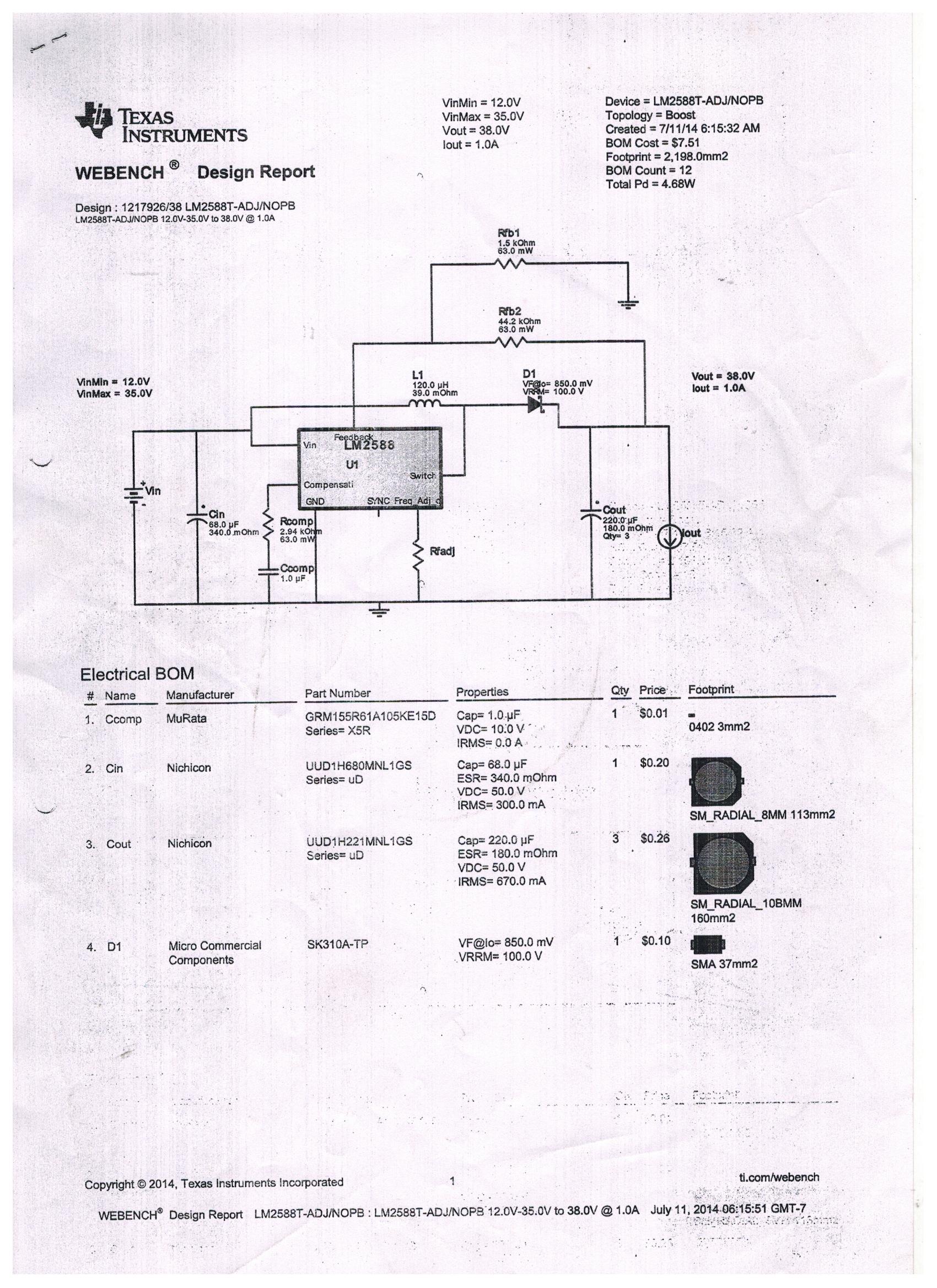

i have attached the circuit design for your reference ,yes TI only LM2588 IC
the input of this circuit requires 12-33vdc so we convert 24vac to dc by bridge gives as input . In no load condition we get output 37VDC , but while connect load ,we used check in power analyzer (PM100) . which we increases voltage by 5 itself using auto transformer , the circuits gets on .
The Load we use is CREE LED spec 38V/1.1A max
Thank you for the details of the LM2588. That informaton is good.

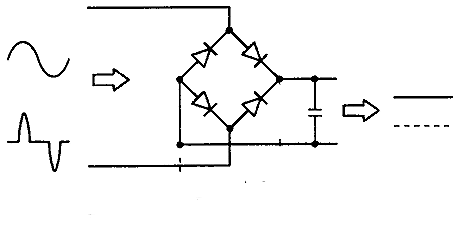

The input current you measure; Is it average (RMS) or peak?
This picture (left bottom) is a picture of input current. The peak is much higher than the average. That is the way it works. 1A average and 3-5A peak is typical.
Is this your problem?

The TI circuit you posted is a voltage source, not a controlled current source. You would have to provide the current control for the LED.

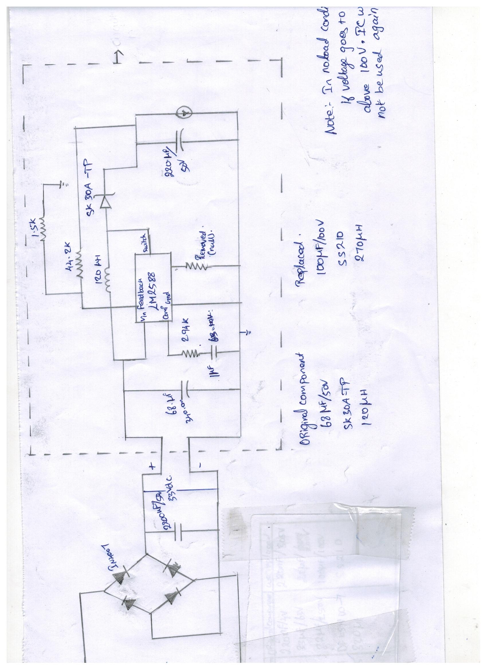

Inductor is very hot and ic ...i had attached the schematic for your reference....We tried this circuit LM2585 same issue occurs ..but the out put for LM2585 is 60V/0.300mA ..
In that schematic you have your LED connected directly across the power supply output with no current limiting (other than the IC's internal shut-down limit of ~5A). No wonder things get hot!
I think you're misunderstanding the example circuits in the datasheets. When they refer to 60V/0.3A output they mean the maximum current you should draw from the supply is 0.3A. The actual output current will depend on the load, which in your case is excessive.
i used two type of loads for LM2585 i used 60v/0.300 mA exact load , were as for LM2588 i used exact load 40v/1A .

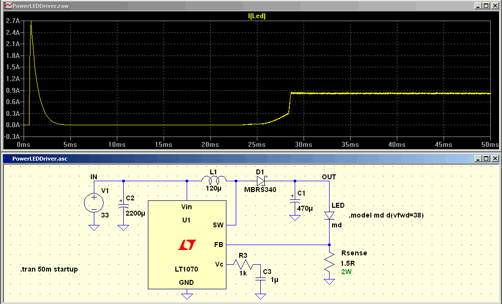

Here's how I would change the circuit to provide a regulated current. In this simulation I used an approximately equivalent LT1070 model as I didn't have a LM2588 or LM2585 model, but the principle is the same; replacing the voltage feedback resistors by a current-sense resistor. If Rsense=1.5Ω the current is regulated at ~0.9A, which should suit your LED (it's life will be prolonged by running it at less than its maximum rating).
Note: This circuit will only limit current if the LED forward voltage (here assumed 38V) is greater than the input voltage to the IC.

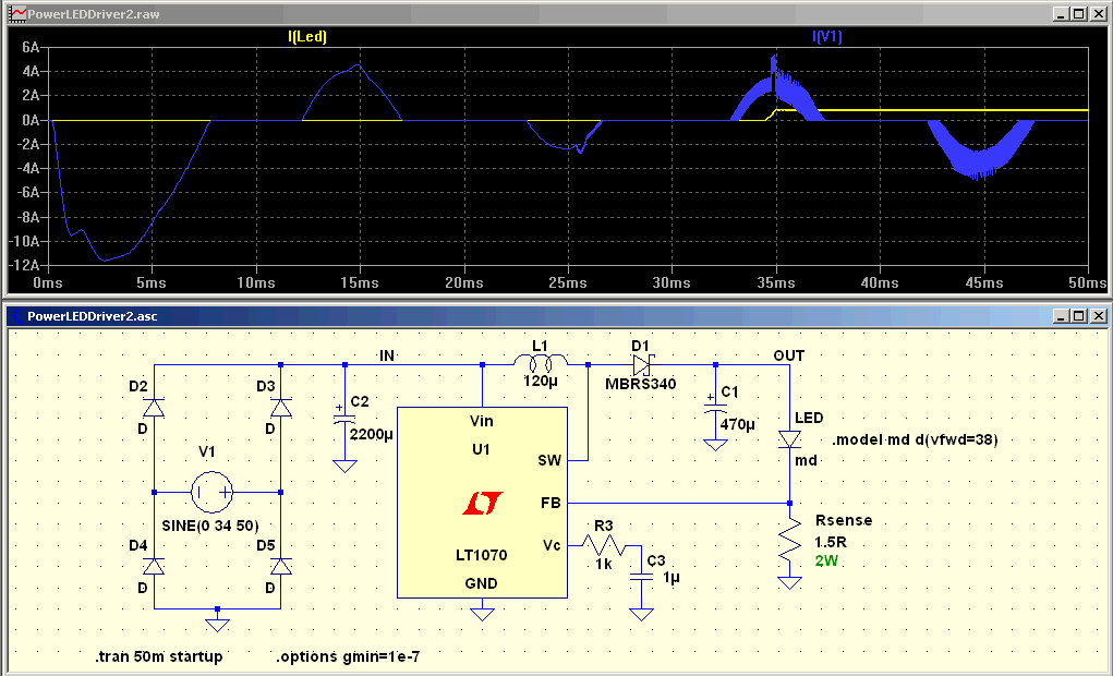

Dear alec_t please try this and kindly give be feedback (give input 24Vac to and convert into dc by bridge and give the filtered output to this circuit ). i will try this circuit also alec_t.
Note. Only input current rise to 2-3A but output current is very less 100-150mA and voltage is 32vdc only at 6vac
Do you mean input current to the IC, or to the bridge + smoothing cap?
Not understood.
Edit: Here's a sim showing current drawn from the 24VAC source.
The IC draws only ~ 6mA to 12mA.
i tried above schematic the input current issue is solved but the voltage in no load condition rises above 100V and ic goes of ...but if on with load condition no issue . i don't have MBR340 so i used MUR420 so any prob in that or i should use exact diode.
