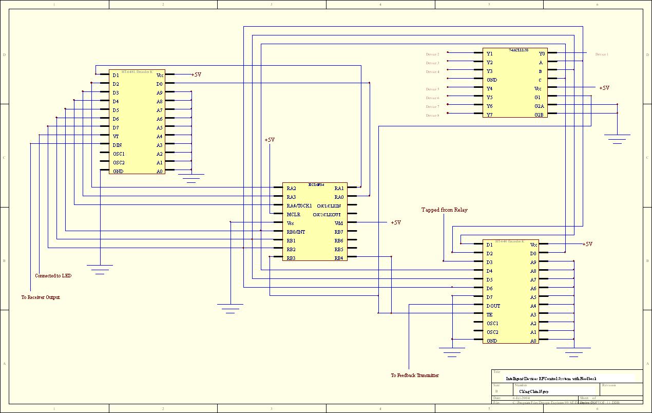

Hi, is me again. This time, I attached the schematic of my prject which I design myself. Can U look at it and tell me is it ok?
Here are some of the things needed to be taken note in the schematic:-
1. D0, D1 is command bit, when D0=0, D1=1 then on/off device will try
to operate the PIC to the on off device subroutine. If D0=1,D1=0,
then subroutine to change group address will be call. (This address will
be checked everytime before any operation is carried out. It is carried
in D2, D3, D4 which are connected to RA2, RA3 and RA4 respectively.)
2. D5, D6 and D7 connected to RB0, RB1, RB2 respectively. These 3 bits
will carry the device ID which indicate which device is switched on.
However, when the operation has change to change address (which
indicate by D0(RA0)=1, D1(RA1)=0), these 3 bits will store the new
address to overwrite the old group address.
3. RB3 is the output pins that I use to trigger on the demultiplexer
(74AC11138) and also the feeback encoder when the on/off subroutine
is called.
4. RB4 is the output pin that I use to trigger on the feeback encoder when
change address subroutine is called.
5. RB5 , 6, and 7 are unused pins.
6. I use the OSC2 pin of PIC and connect a resistor(330K) parallel with
capacitor (220nF) for oscillation function. Is this a need? :?:
My concern..sorry oh..
1. Does my connection ok?
2. Do I need to connect a resistor to every input pin in order to protect
the PIC?
3. OSC1 need to connect?
4. OSC2 need to connect?
5. The MCLR connected to high always right?
My PIC Program , I will upload it in the next post reply. And Also my question is I already test the program with MPLAB and it shows OK, NO ERROR. Hwoever I cant get the output. Can U just have a look on my program.?
Is there any software that we can simulate the PIC on the computer screeen itself/?
Thanks, Hope my question is not making U feel angry..Thans very much!

As for your oscillator query, the 16F84 requires a resistor and capacitor for an RC oscillator - if you replace the obselete 84 with it's replacement, the 16F628, it has a fully internal 4MHz oscillator - this gives you 16 I/O pins, and is cheaper than the old 84.
Thansk Nigel. By the way, can u spend some time on my schematic diagram and try to give me some opinion on my questions? Sorry, :oops: :oops: :oops: Thansk a lots.........I have no choice but to use the PIC16F84 because I have bought it. For my case, the timing issue will be a problem? Thanks...
I'm rather confused as to what all the chips are doing?, it seems pointless using the Holtek chips when the PIC can quite easily perform the functions of both?. If you look at my remote control tutorials I transmitt and receive Sony SIRC remote control signals, it would be trivial to modify those routines to do what you want.
the PIC?
No.
Yes, as I remember it's the RC oscillator pin.
No, unless I remembered wrong, and this is the RC oscillator pin.
Yes.
You seem to have concerns over timing accuracies, if so you should be using a XTAL oscillator - the external RC oscillator is the most inaccurate you could possibly use!. On the 16F84 you don't lose anything by using a crystal, unlike the 628 the OSC pins are fixed and can't be used as I/O.
