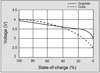

The cutoff voltage should never in practice be below 3V and 3.2V is "flat" level, for any LiPo cells made in the last 20 years or so.
See the solid line plot on this graph; the dotted line is for an older cell chemistry used in the 90s:
If you discharge below 3V they should be recharged soon after and not left flat for any length of time.
If lithium cells are allowed to stand either at very low voltage or held at maximum voltage, they decay far faster than if the voltage averages around mid-range. Reducing the charge "span", eg. 90% to 10% significantly increases the overall life of the cells.

A more modern LiFeP04 cell is charged to 3.65V max, is nominal at 3.0V to 3.2V and has a minimum allowed voltage of 2.5V but a cutoff at 2.75V is fine.
