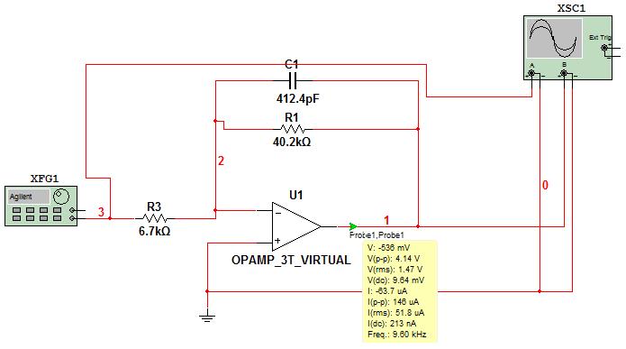

Hi, thankyou all for your input and your explanations.
The frequency at 9.6kHz is the breakpoint frequency hence half the gain - I didnt really make it all clear enough.
We used the simple equation breakpoint freq = 1/ 2piRC
So thats C = 1/2pifR
The resistor is what I use in the feedback in parallel with the capacitor, basically the resistor becomes the 40.2kΩ. Therefore using the equation above I get a value of 412.4pF.
This gets me a gain of -6 at 1kHz and a gain of -4 at 9.6kHz according to multisim
In theory I should get a gain of -3. I should get an Xc of 40200Ω which in parallel with the resistor makes it 20100Ω which should give me a gain of -3. Is this just because multisim is useless or is my working wrong.
This is how the teacher told us to do it. I have attatched my circuit diagram.

Yup, you'd get that result treating the Xc as another resistor, but the capacitor is reactive! When one takes into account the phase angle, the j in the complex plane, the Xc is not constant like resistance through one cycle at a given frequency.
When I worked it, I got a little different answer than Roff because I rounded to standard E48 and E96 values; C=715pf and R=41.2k. Close enough for 10 of 10 for both of us if I were back in the classroom in front of the podium.
The reason the Multisim results didn't match the calculated results is not the fault of Multisim, but rather the fault of the approach. The difference between a gain ratio of 2, the desired result, and that of 1.5, the Multisim result, is ~2.5db. That is far from the mark. That puts the 6db rolloff out at about 13khz rather than 9.6khz; right where using C = 1/2pifR to resolve the problem would put it.

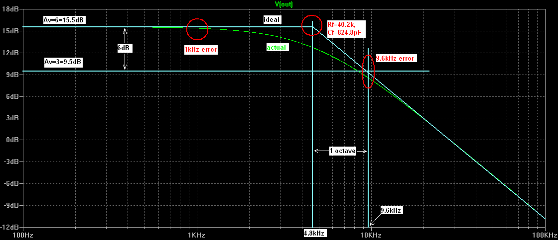

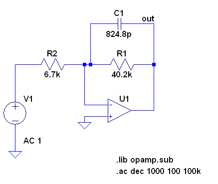

Your results are not what I get by using the breakpoint method. See attached.
  • vonsproken's op amp problem.asc
Your capacitor value is twice that of mine.
1 / 2 x pi x 40200 x 9600 = 412.4pF
Yours is wrong. The RC feedback rolls off at 6dB per octave. To get 6dB attenuation at 9.6kHz relative to the DC gain (your teacher used 1kHz), your breakpoint needs to be an octave below 9.6kHz, i.e., 4.8kHz. Did you study the graph I posted?
