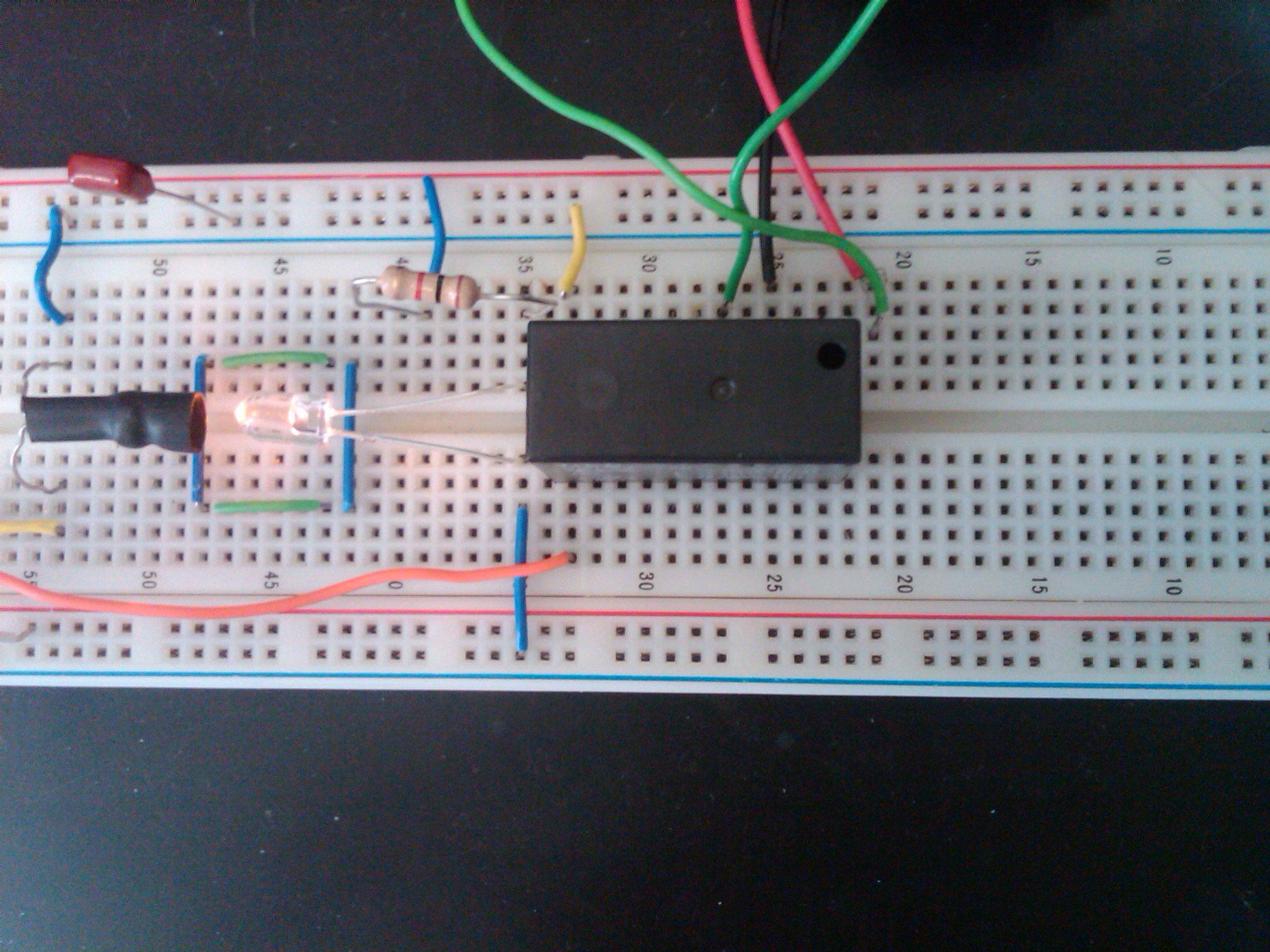

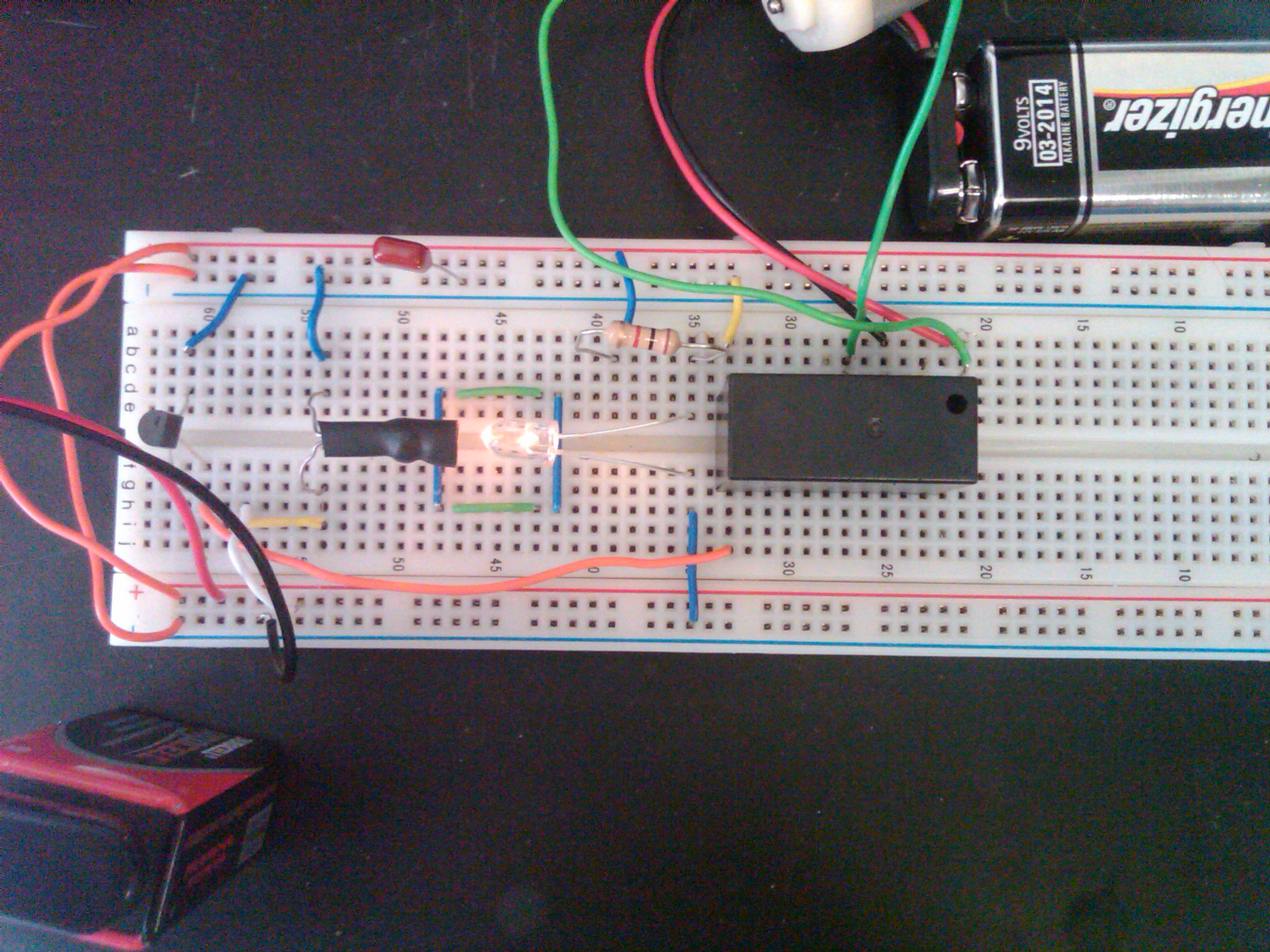

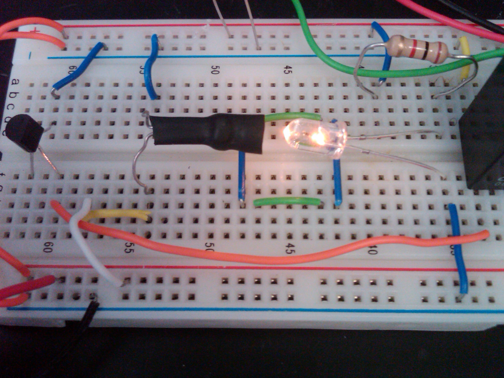

I have attached current photos of the circuit. At this time the LED and photoresistor function properly, but the relay does not trip when the light is removed and my engine continues to turn.

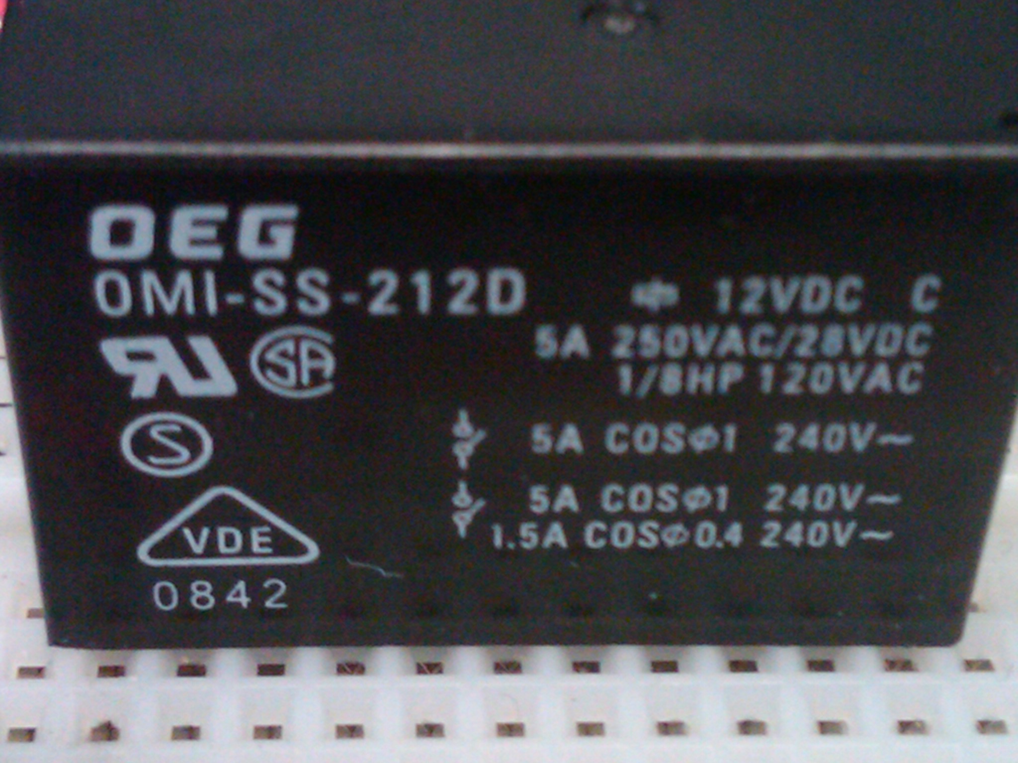

The transistor used is a Mosfet 2N7000 and the Relay is 0MI-SS-212D. The photoresistor was purchased from radio shack and had no specs on it.

In the last picture, it looks like the transistor is only connected to the relay and the ground rail. The third leg goes nowhere.
And the connections of the shrouded black thing look suspiciously dodgy.
