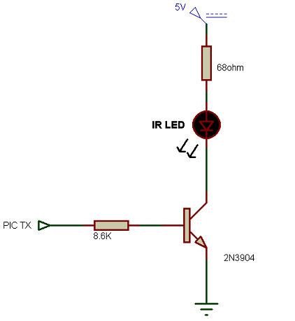

I'm building a simple IR transmitter, just wanted to know if this circuit is ok, or if it could be improved.
The IR LED has a 1.6V Forward voltage, and operates at a nominal 50mA. The closest I could get, with the below circuit, was 44.9mA, is there a way I could run it right on 50mA?

Morning gramo,
If you have the space, you could parallel a 'higher' value across the 68R.
I take it you dont want to use a 'special resistor', how many such LED drivers are you building?
Is the transistor saturated, it appears from the calculations, there is about a Vces of 0.25V,
you could drive it harder with a lower value base resistor.
Regards.
Did you measure the current at 44.9mA? There is about 0.3 volts drop across the transistor that you may not have counted on. If you want to bump up the current by 10% drop the resistance by 10% or choose the next smaller value. Only 10% will not effect the range of you IR project.
What duty cycle will you have the LED on. I do not know your application but if you can guarantee that the LED will be on for no more that 50% of the time you can almost double the current. There should be graphs for that LED showing duty cycle and current.
The base current is too low for the transistor to saturate properly.
Every transistor's datasheet shows its saturation voltage with the base current at 1/10th of the collector current.
Your base current is only 0.5mA so the transistor would saturate well if its load current is only 5ma.
A PIC can supply an output current of up to 25mA so try a 680 ohms base resistor for a base current of about 5mA.

I'm about too hit the hay sack, but I'll fit in one more post :eek:
I cant take the base resistor lower, but how low can I take Vce (how hard can I drive the transistor) to keep everything safe for long term use?
I just noticed I used an 8.6K resistor on the base - it should be a 8.2K
It doesn't change much, but yeah, you get the picture :p

Sorry audioguru, I posted when you did...
Thanks, I'll give it a wherl
Instead of wasting so much power in the resistor, put two IR LED's in series, this means you can use a MUCH lower value resistor, and output a lot more IR with no increase in current consumption.

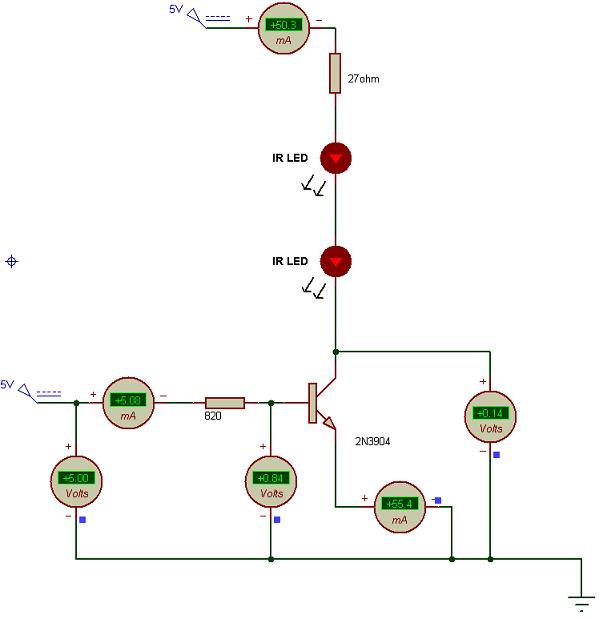

Yet another great idea nigel. Here's where I'm at with the new mod's, sorry about all the meters, just want to be sure :eek:
I'd love to take credit for it, but it's common practice in older IR remote controls - where you had four batteries.
Series resistor seems a bit high?, notice my tutorial only used 4.7 ohm - for IR you're looking for short high current pulses and low duty cycles.
I've had issues with this in the past, perhaps a little guidance would help me out,
How do you calculate what resistances to use when PWM signals are used. Obviously as PWM frequency increases, the transistor has less time too turn on and off (not fully driving the IR LED), and the opposite for slower PWM's
For IR remote control you pulse the LED at high power but low duty cycle, this maximises range, and keeps average current consumption low.
Speed of switching isn't a problem, as you're only using 38/40KHz, and it's not crucial that the transistor switches rapidly (as it is in switch-mode PSU's).

Thanks Nigel, but what lead you to use the 4.7ohm resistor, instead of something higher like you would use if the IR LED was on continuously?
In your tutorial you say;
As the receiver detects 38KHz modulation, we need to pulse the LED's at 38KHz, this can be done by feeding the LED's with a 13uS pulse followed by a 13uS space - in actual fact I decrease the pulse length, and increase the space length (keeping the total length at 26uS) - this reduces the power consumption.
How much did you lower the duty cycle by in real life?
gramo said:
QUOTE=Nigel Goodwin]Thanks Nigel, but what lead you to use the 4.7ohm resistor, instead of something higher like you would use if the IR LED was on continuously?
The 4.7 ohm was accurately calculated, after great deliberation :D
5V supply, 1A maximum required - 5 ohm resistor looks good - completely ignoring the voltage drop across the LED's and transistor!. Obviously, if you were looking for maximum possible range, you could reduce it substantially, but with 4.7 ohm it has a similar range to commercial IR remotes.
I can't even remember now, I think it was something like 40/60?, but the SIRC's system has nice wide gaps in between the pulses anyway, which further reduces dissipation in the LED's.
