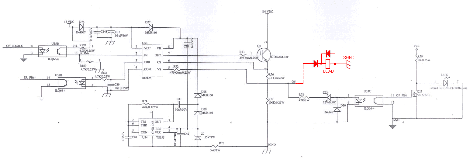

I am using the following circuit for high side driving of an IGBT. Details of the circuit are as follows:
+ HV is 110 V DC
IGBT = CT60AM18F (60Amps/900V Mitsubishi)
Rg = 39 Ohms / 0.25W
Rs = 0.1 Ohm / 2W NIWW
Instead of 100K (between HVRTN and pin-1 of 555 IC), I am using 56K/2W and instead of 11DF6 and 1N4148 diodes, I am using MUR160 diodes. My load is inductive and is a contactor coil of approximately 200 Ohms resistance
My problem is that, when I am applying short circuit, with system on load (fault under load) condition, my IGBT is sustaining the short-circuit and is protected. But if the load is short circuited first and then the supply is switched ON, there is no protection coming into picture and my IGBT is getting punctured (Gate – Emitter – Collector – ALL SHORTED).
already have a 4.7KOhm / 0.25W resistor connected
to Ground from IN pin. So is is guarenteed that the
IN pin is pulled to LOW during start-up.
I have sepearte power for 110 V DC at +HV and +8V at the
IN input. The exact circuit I am using is attached herewith
for your reference. My inductive load (Contactor coil) is
connected between O6 and SGND i.e, in parallel with the
100k/0.25W resitor in the circuit attached.

A schematic diagram would really help.

I am using the following circuit (attached herewith) for high side driving of an IGBT. Details of the circuit are as follows:
1. + HV is 110 V DC from a battery bank.
2. High side Driver Used – IR 2125
3. IGBT Used – IXEH40N120D1 (60Amps/1200V - With HiperFRED )
4. Rg – 39 Ohms / 0.25W
5. Rs – 0.1 Ohm / 2W NIWW
Load is connected between O6 and SGND in the circuit attached – Load is inductive in nature (coil of a contactor with coil resistance approx 300 Ohms). The load i.e., the contactor is located at a distance of approximately 10 meters from this circuit and there is no provision for providing any protection mechanisms or components on the load side.
I have separate power for 110 V DC at +HV and +8V for the IN – input of IR 2125 is derived through a power supply, whose input is again the same 110V DC. I already have a 4.7KOhm/0.25W resistor connected to Ground from IN pin of IR2125, so it is guaranteed that the IN pin is pulled to LOW during start-up.

Maybe the Q of the coil is too high. Try to alterate the nature of the load by connecting a resistor across the coil of the contactor.
Or, try to connect a fast diode diode across the coil (inverse), and a series diode (direct).

A resistor with a diode in series is the best way of doing it. If you omit the resistor current will decay at the diode's voltage drop * inductance, whilst adding a resistor will cause it to decay exponentially.

I do not understood how you performed the shortcircui test, as you described. In my opinion the case 2 and case 3 are the same. If you shorted the load when has no voltage on the circuit, and, after this, you switched-on 110VDC and 8VDC, your load was a jumper (R=0, L=0) even if before the load was an inductor or a resistor. Or, you said

Who tells to circuit what before was in place of the jumper, inductor or resistor?
Another obs:
If the load is shorted when is no voltage (switch-off), and after this you apply the supply voltages, the charge pump circuit using 555 and asociated components, can NOT start, because, in the normal working, the 555 take supply voltage from the LOAD (load voltage) via resistor R75(56K/1W), this voltage charges the 100nF capacitor C42 connected between pins 8 and 1 of the 555 generating minus 15V referenced to pin 5 of the IR2125, necessary to prepare the auxiliary voltage for the bootstrap circuit. During the load is shorted, this voltage is zero, and the 555 is not working.
Another question:
Why you choosed like this expensive IGBT, 1200V/60A, if the supply voltage is 110VDC only, and load is 300 OHM? Do you have another suplimentar loads instead of DC-contactor coil? Why not MOSFET? (usually rated voltage of the IGBT is 600V and over, I never used IGBTs rated under 600V, maybe they are not available, I looked for it..) In the shortcircuit conditions, the load is about 20m wire (cable), or not? (You said the contactor is located at 10m distance from the PCB containing IGBTs).

"Here is an Application Note "Using The Current Sensing IR212X Gate Drive ICs" with other possible configurations for the current sensing. May be it could be better to use the configuration like described on page 6 (Desat Detection Circuit Configuration) or page 4 Figure 3a.
In this circuit you use the IR2125 it's not possible to use the current sense
function. Therefore you need a MOSFET with current sense pin. What you have is a normal Transistor and you are measuring the current flowing through the 100kOhm resistor and not through the load. Please see the datasheet on page 1 typical connection... this MOSFET has 4 pins (drain, gate, source and current
sense).
When the output is turned on the CS is blanked for a short period. This may be sufficient to destroy the switch. To limit the rate of rise put an inductor (with diode) in series with the switch.

What is your load?
I can't see any low side switch in your schematic, but diode and capacitor bootstrap applied, it will not work if the output voltage never reach the ground.
For only 110Vdc i better to use mosfet, 500V rated mosfet still low Rds-on.
IRFP460 only 0.2 ohm when switched on. I see that your current sense is 0.1 ohm, too big for high current.
Sorry, your load is 200 ohm contactor, low current. I think mosfet is better.
