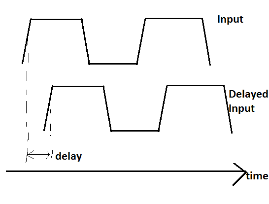

Nice example. But I think it needs a bit of clarification. I think the circuit should have been like
DATA------Invert----Invert----D (added 40nS of delay to the Data)
CLOCK--------------------------C
This gives negative hold time and positive setup time for the circuit(which includes the FF and the 2 inverters) between CLOCK and DATA.
Or in simple words. Since the DATA changes 3ns before clock which is not to our liking(We want the flipflop to process the data before this change) we delay it by some time so that the data changes well after the clock and that change is not reflected in the flipflop.
It is like a running race. DATA finishes(arrives) 3ns before CLOCK. There are 2 ways to rectify this. Either delay DATA or make CLOCK faster(reduce delay between CLOCK and C). In real time circuits we only have delay elements.
I gave the above clarification based on my understanding of the problem. I might have incorrectly interpreted it.
If the intention was to make the Flipflop process the new data(ie the value of DATA after the change(3ns)) then the circuit given by ronsimpson is correct but still that will give positive hold time and negative setup time for the circuit(which includes the FF and the 2 inverters) between CLOCK and DATA.
Some of my friends do not like the concept of negative hold time and negative setup time(especially -ve setup time). A flipflop as such cannot have -ve setup time. But the circuit as such can have if the clock is delayed as above.

I think that Nara is right - for having negative Hold Time, you need to delay the DATA, and not the Clock.
Delaying the Clock will make the hold time become positive.

By Delay the data, i mean to add delay to the data path between the source and the FF's Data Entry.
if you add 40ns delay to the data Path, in relation to the Clock Path (assuming there was no delay difference between their paths before this addition), that means that:
if the FF Setup Time is 17sec, then the Data needs to be stable 57sec before clock
If the FF Hold time is 0sec, then the data needs to remain stable up to 40sec before the clock changes.
Did that answer your question?

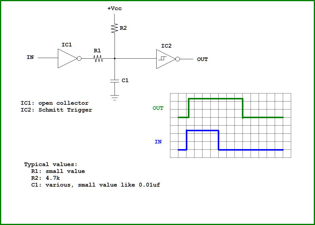

Using a capacitor directly with digital logic in the data or clock path is not a recommended practice although it has been done. Basically a capacitor is an analog device and a digital logic gate is a digital device and they have to be treated as different species. The capacitor could very well change the setup time as well as the hold time, and more importantly, it causes an analog signal to be developed at the input of a digital logic element...something that should definitely be avoided.
The exception is when using a specialized gate such as a Schmitt Trigger. In this case, we can construct an asymmetrical delay element using for example a resistor, capacitor, open connector gate, and Schmitt Trigger inverter. This would delay or stretch one edge of the data but not the other. To degeneralize a little, say we have a data signal that goes high before the clock and goes low later, and we want it to hold high longer. In this case we would want to stretch the pulse out so that the falling edge happens a little later than the actual signal falling edge but we want to leave the rising edge alone. This small circuit would be built using the above mentioned parts, and is very similar to a MOSFET asymmetrical drive circuit.
Of course it is also possible to simply use another flip flop ahead of the one in question and control the output state accordingly, but the pulse stretcher above is probably the simpler solution. That kind of circuit has actually been used in some consumer and government equipment. If you'd like to see a schematic i can supply one.

Delay hear means just adding a buffer(or 2 inverters). Here is a crude example
You can interpret it whatever way you want. But remember it delays the entire input signal(it does not alter or stretch the signal). If you want some portion of the input signal to get delayed(that is you want some part of input to kindof expand then you need to use the schmit trigger kind of circuit(posted above)). But that alters the waveform which may not be the intention unless you want to be partial to some values of input.
