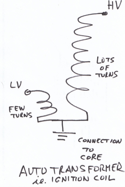

Is this like the magneto ignition coil in my Briggs&Stratton Lawn Mower?
If it is, then the resistance from LV to core should be low, a few Ohms.
The resistance from HV to core should be higher, a few hundred to a thousand Ohms.
The resistance from LV to HV would be the sum of the two readings obtained above.
There are actually two separate windings (four ends), but two of the ends are connected to the armature core.

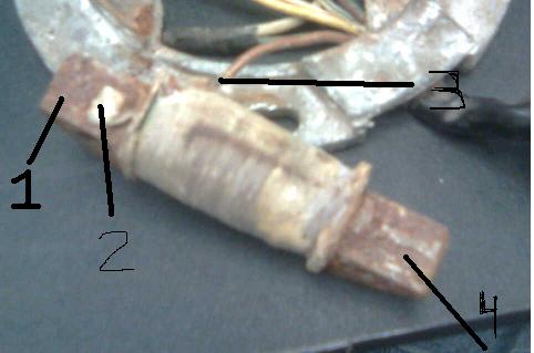

hmm, i'm going to post some pictures of the coil. I'm working on it right now. It seems like I have an open from one end of the wire to the other maybe.
Okay, I'm posting a picture of the coil I'm working on. It looks like point 2 is the start of the wire, is that correct possibly? Point 3 is the wire that comes out of the windings and goes off to the ignition coil.
From 1 - 2 i measure a short.
1 - 3 I measure about 250 ohms
1 - 4 i measure a short when i move the dmm's leads around in the hole's of the core.

It looks to me that your coil is ok.
1 and 4 are just the ends of the core, so a short is to be expected.
2 is electrically bonded to 1 (& indirectly to 4), so a short is to be expected.
2 to 3 is the end-to-end resistance of the coil.
If you reinstall the coil, leave wire 3 open, connect your Multimeter in AC volts mode between 3 and 1,2 or 4. Spin the crank to see if you get a small kick as the magnet moves past the coil's core.

According to the picture that you have and the descriptions of the shorts/ resistance checked, I would agree with mike on this ( the coil appears to be good ) Chances are 1 or more of your magnets have lost their magnetizm, And this is possible!!!!!!! Or the problem may be your ignition coil, you could have a short or open!! Could even be that the ground to the ignition coil has failed, Check the ignition coil before doing any more disassembling
