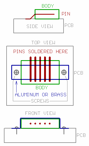

Hi Tipsy,
this would be my approach for one and (almost) forever.
Use thin aluminum or brass (0.06mm) and bend it to fit snug over the connector. Use watchmaker's screws to fix the enforcement to the PCB material.
(I used that method to hold to two AA-batteries and they haven't come lose within five years.)
If there is no space for screws (because of traces) you might use super glue.
Boncuk

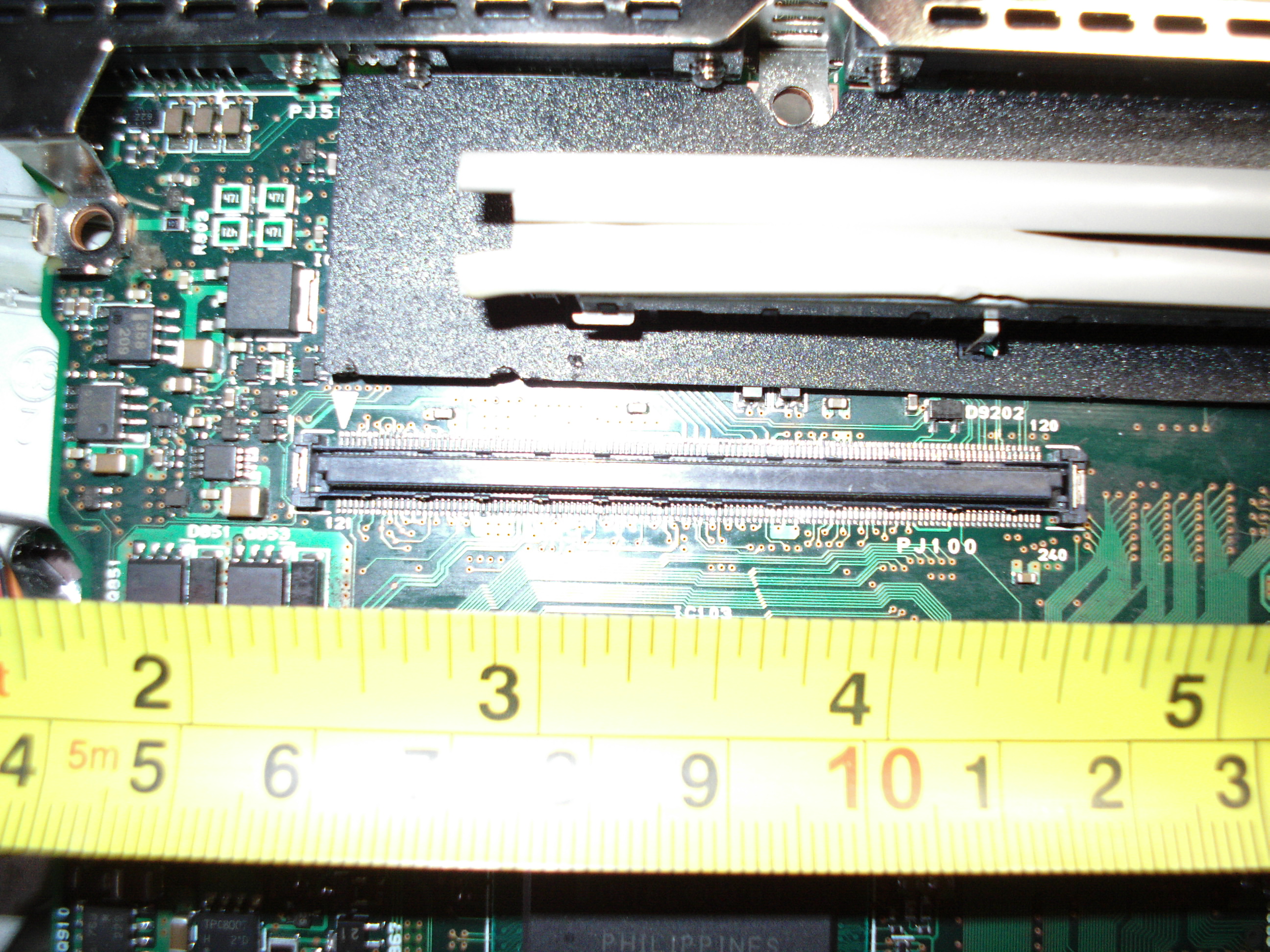

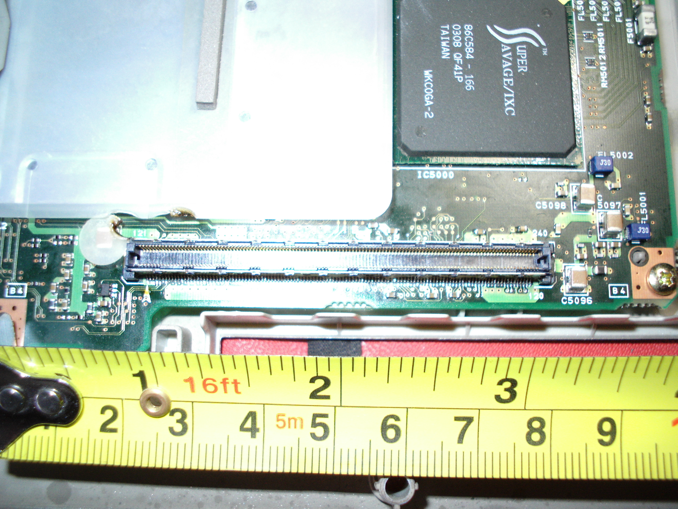

These are the connectors in question, just to give an idea of shape and scale.
I can't see a surefire way of clamping these but can envisage running a bead of liquid glue over the legs but I'm unsure if the ingredient chemicals are safe to use on PCBs?

If it's safe to use and won't cause corrosion, that'll do me, thanks!
hi T,
The only problem in using a permanent fixing method is that if it breaks again, you wont be able to get at it to fix it.;)
Hi Eric, that is true but without the added support, it will break again too easily. Hopefully, this is a permanent fix. Not a biggie if it doesn't last.
I have used epoxy resin on PCBs with no problems before.
Eric is right that it's permanent but it shouldn't be too hard to remove. Although it's thermosetting, heating it in a re-flow should weaken it enough for you to be able to scrape it, especially if you heat then apply a suitable solvernt.
Use epoxy to stake just the connector housing to the board (no need to epoxy the contacts to the board). I use Scotch-Weld EC-2216 Gray adhesive.
