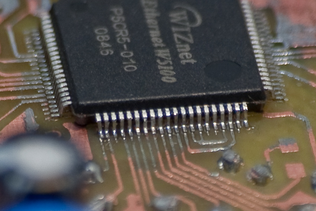

Is there any way for a hobbiest to work with a chip this small?
Triode
This particular one is a MP3 decoder from sparkfun
I'm probably not going to get that advanced for a while, for now I work with DIPs, but do hobbiests work with chips this small? And how do they do it? Seems like it would be very difficult, but theyre selling it on a site for students and hobbiests so there must be a way.
If you can print the circuit boards for it. The hardest part is lining it up, you just use the right amount of solder paste and heat it up with a hot air tool, the solder wicks to the legs and the copper all by itself. It can be touched up with pencil iron. I wouldn't wanna try it but it's doable if you're dedicated.
They have tutorials for doing it with a soldering iron as well. It's not that hard.
Can you link to some tutorials that show that done with a soldering iron Dirtylude? I'd like to see em. There are so many packages that use that general package style it'd be useful to try.
It's right on the Sparkfun site under 'tutorials'
SparkFun Electronics
YouTube - Solder wicking a tight pitch IC
I don't do it quite that way.
Tin one lead, tack the IC down in the right position. Tack down and opposite lead to hold it still. Solder the rest as best you can, then use the wick to soak up any excess.
I've done 0.4mm lead IC's this way and 0.4mm lead is uncommonly small.
pretty impressive dirtylude
I'm surprised those hot plate and toaster oven methods they show dont bake the pads off the board. I guess if theyre made to take the heat they can, its just surprising.
I'm more of a professional than a hobbyist, but I can do something like that with little very trouble. It takes the use of liquid flux and drag soldering technique. That is the best way IMO, there are videos of the technique on youtube. The techs at the places I have worked would all use the drag soldering technique, that's where I was originally introduced to it. 0.5mm is finer pitch that what I typically do, I usually don't screw around with anything smaller than 0.65mm (ex. TSSOP and smaller TQFP) but I am working on a project right now with an MSOP-10 that has .5mm pitch pins. I'm more worried about getting the solder pad dimensions right in my layout editor than I am actually soldering it.
I find the drag soldering technique with lots of liquid flux so useful that I went and bought a gallon of the stuff (Kester 951) for my own personal use at home. Much less expensive than buying it 10ml at a time in flux pens. I think shipped it was $50 including the hazmat fee.
And that is a helluva job on a .4mm pitch device on a home etched board no less.
Triode you have to keep in mind, a toaster oven is only slightly less advanced that an IR reflow oven. The stuff they use commercially is nothing more than glorified highly controlled pizza ovens! They're just engineered slightly different for better control and even heat distribution.
Thats true, and it makes sense, but I'm not even sure how the professional ovens dont just toast the board. What kind of heating do they use?
They call it IR reflow for a reason. They're usually quartz IR heating elements. They just pass the boards under the heating elements and cooling sections at a constant speed and everything comes out perfect. Just like a pizza oven. The station usually has a programmable speed and heating element so that the reflow curve for the board under process can be matched. Some boards have parts more sensitive than others so they pre-heat and use different heating/cooling curves, but it's all really pretty simple. If you want to see something incredibly complex try to find video of a pick and place machine working, THOSE things are impressive, and all they do is toss chips on a board.
