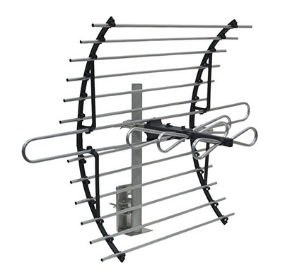

Years ago when Win7 came out, I cranked up Windows Media Center (WMC), got two Hauppage tuners (later a single unit with two tuners in one package - $73USD) and a decent antenna: like this one - $32USD...
Actually that's a pretty crappy aerial, not a 'decent' one at all - more a toy than a proper aerial, and will have VERY low gain. As long as you're in a seriously strong signal area it will be fine, but it's about on a level with set-top aerials.
That's rather harsh, Nigel. It works very well for my purposes.
As you say:
... As long as you're in a seriously strong signal area it will be fine...
We're "line-of-sight" with the tower.
... Sorry if you thought I was harsh, but calling it 'decent' offended me :D
Apology accepted, Nigel :joyful:. (I'm marking that one down in my "Notable Mod Posts" file...) :woot:.
And I apologize for offending you as well!
upload_2018-7-21_16-39-17-png.113841
Well, I guess it all depends on how you define "decent".
Looking at CBBs picture, there appears to be a long folded dipole in the plane of the (parabolic) reflector.
This dipole appears to be intended for VHF.
There are three "bow tie" elements of different sizes for UHF , how they are connected is not clear (to me), my best guess is that they are all connected in parallel with the VHF folded dipole.
The differing sizes of the UHF elements implies that this antenna is intended to be a wide band, low gain, one size fits all type of thing.
The reflector, for all its elements, is unlikely to have any effect at VHF, and a small effect at UHF.
Well, there you go!
Likely a good signal strength area, a low gain antenna is fit for purpose. End of problem.

This is my antenna. After I made reflector screen larger signal strength increased. After I changed wire bow ties to solid aluminum signal doubled. At 40 miles it is over kill now matter how bad weather is signal never fades out. It gets good crystal clean signal at 65 miles. I only have the antenna 8 ft high at the new house we are 40 miles from all 44 stations.
These are called 'short backfire arrays', and used to be quite useful - they are low gain, wideband, but have excellent anti-ghosting performance. However the advent of digital TV has rather 'killed them off' as there's no need for anti-ghosting any more :(
We used to fit quite a lot of them, in specific areas where ghosting was an issue - they were also remarkably resilient, and most we fitted are probably still in use. Luckily the manufacturer chose NOT to deliberately fit rusting steel parts to make them fall down in a few years :D The same can't be said of various other large aerial manufacturers!.

the $32 antenna has a folded dipole for VHF, and a 3-element yagi (actually 4 if you count the reflector)for UHF. i think that VHF element is too close to the reflector, and there's probably little or no gain on VHF.

the purpose of the "bowtie" elements is to widen the bandwidth of the antenna elements, because larger diameter elements have a wider SWR bandwidth than do narrow ones. that's why a discone or biconical antenna is often used for VHF and UHF communication systems. a variation of this that has a VERY wide SWR bandwidth is the planar disc antenna, where the bandwidth of the antenna can be measured in octaves or decades. the lowest frequency is determined by the overall length of the antenna (twice the diameter of the discs), and the highest frequency by the spacing of the edges of the discs at the feedpoint. i am currently keeping my eyes open for 20 inch pizza pans to build an antenna for use with an SDR radio. i want to include the 2 meter ham band, which is why i'm looking for 20 inch pans. there's plenty of 16 inch pizza pans, but in most stores, that's the largest they have.
