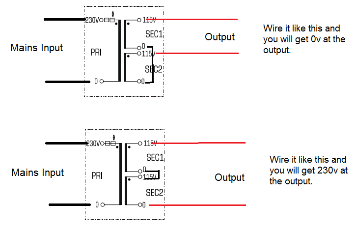

Hi, I have just purchased a BLOCK Iso transformer TIM100, 230v to SEC 2x115v. I stress I am a novice at electrical work, but despite getting adequate readings in on the Primary and readings out on the Secondary, I cannot get any power from the outlet mains lead socket. Could anyone tell me why all seems okay but I cannot get any joy from the output socket itself. All wiring seems to be okay on inspection? Driving me mad trying to figure this out?
Your description is a bit short on detail, but let me have a quick guess.
See the pictures below...
The dots are polarity or phasing marks. Windings in series can add or subtract voltage, Windings in parallel increase curret, but should be from the same model transformer and must be the same voltage.
