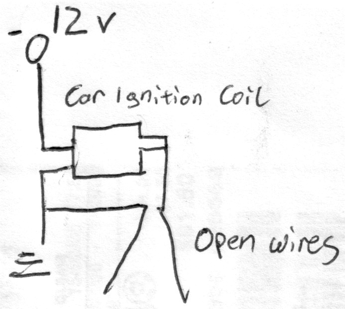

My next project is going to be making a jacobs ladder. Most people have it done using a high voltage source such as a neon sign transformer, but im want to do it using a high voltage car ignition coil which should do the job. Below is my rough schematic i have drawn. Any opions?
The open wires is wire the voltage jumps (would this provide enough resistance in the circuit to cancel putting in a resister?
I am buying a BOSH 716 ignition coil would this be enough? (12v dc in voltage out=???)
Picture attached

An ignition coil needs to have interrupted DC to output high voltage. And it's extremely difficult to transfer enough energy through an ignition coil to maintain the plasma arc necessary for the Jacobs Ladder.
Thanks for that? Any ideas on how to do it using a car ignition coil then? Schematic would aslo be helpful

Ignition coils are not manufactured to create an arc larger than a spark plug gap (40-50 mils). Anything larger and the secondary voltage rises above specification and can cause arc within the transformer, damaging it.
I have seen coils survive large spark distances when resistive plug wires deteriorate. However the coils are not guaranteed to withstand it.
Hey, if it's just for fun anyway go ahead and use it - I would.... just be aware.
ok thanks for that explanation, i now understand allthough ive seen many people over the internet do it. i might ditch that idea and try and find a high voltage transformer. what would the electrical design be for that?
I've run ignition coils with 1" long spark gaps long term with no problem. They're even fine when being run and not having any discharge (max V spike on secondary). My scope showed that I was hitting 15kV spikes on the output. The coil I was using was an MSD Blaster 2 IIRC.

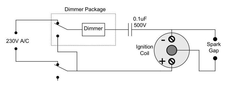

I found two websites which demonstarts succesfull using a car ignition coil to run a jacobs ladder. It uses 240vac to a dimmer switch and a 3uf motor cap.

here is the website which shows the schematic
Here is another one that uses an ignition coil and dimmer:

But wait in the schematic which picasm recomended it just has straight 240v AC going into the car ignition coil...... Arnet ignition coils meant to run on 12V DC???
But wait in the schematic that picasm recomended it has 240v AC going into the car ignition coil. Arent the ignition coils meant to run on 12v DC????
schematic atttached
You don't see the lamp dimmer and the capacitor in series with the mains voltage?
so your saying a dimmer switch and a capacitor transforms ac to dc aswell as reduces the voltage???
Dosent a AC dimmer switch vary the herts the sign wave ocilates and a capacitor holds/filters current? Or am i totally off topic
A lamp dimmer doesn't vary the frequency (measured in Hertz).
It works by turning on the lamp for only part of each half of the main cycle. Twice each cycle the dimmer turns on the lamp voltage very quickly rises from nothing to the full mains voltage.
The capacitor is filtering in this application. It lets the fast rise through to the coil, but stops the main frequency current which would overheat the coil.
Have a look at my post about coil voltage. Coils have to work with large peak voltages and 240V is quite normal for an igniton coil.
so theoretically speaking...the above schematic should work?
Aswell is a 700w dimmer switch ok? if not how many watts are used??
