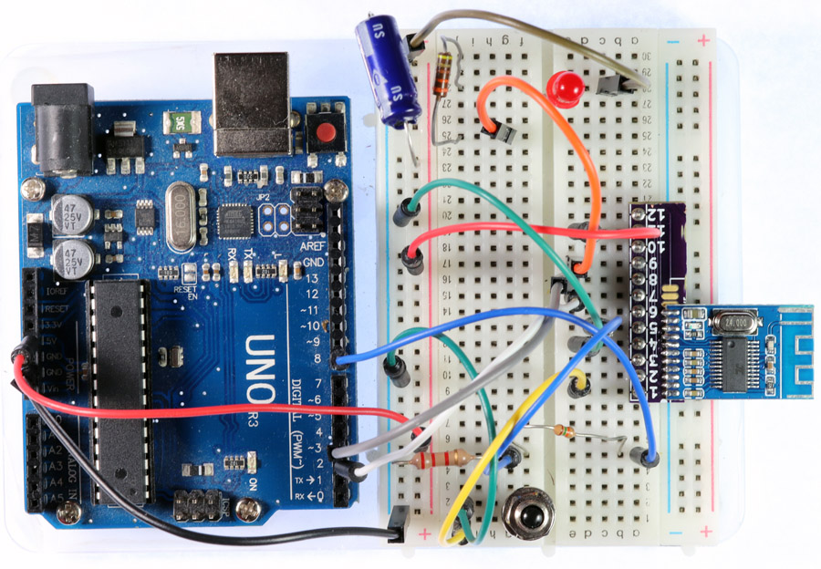

First thing for me to start playing was to get the module on a breadboard. Those interface connections are 1.27 mm centers. That is a PITA that I have dealt with before. Usually, I use a small breakout board (on the left). I had previously purchased some home-made boards when the ESP32 first came out. They either changed the chip footprint or the chip and/or I waited too long. Net result is that I could not find those "original" ESP32s and I ended up with the bare boards and no way to use them (on the right).
Glad I saved them because they came in handy. Enter the Dremel with the "buzz saw" attachment and the usual reminder to myself to buy a better suited vice so I don't cut my fingers off.
So, with some magnifying glasses, a few grunts and curses and I managed to make it work. Not pretty, mind you , but pretty enough and close inspection reveals no shorts or bridges or any of that bad stuff. Added the header pins and now it is "breadboard ready".
A couple of points to note: First, there are only 11 pins on the board and I cut the breakout to 12 pins. I know, I did it in case the saw got away from me and then later saw that there is a ground fill on the breakout board that I figured I could use on pin 12 (which I have not done).
The other thing is that the numbering on the breadboard is the exact opposite of the schematic. No problem for me, I drew myself a little table to make sure I would not get confused.
Time to breadboard a circuit. I basically used the schematic shown in post #2, but instead of a USB/Serial board, I used an Arduino UNO.
The UNO provides the +5V.
I also used a resistor divider (15K/2.2K) from GPIO 8 to ground with the midpoint going to Audio in (IN_L or IN_R, it doesn't matter) and the AGND to the UNO (and board) GND. I was not concerned with high fidelity, but instead, I want to conveniently present a signal to transmit. The Arduino can do this with a simple statement, e.g., tone(8,1000);
I used software serial and this simple terminal program.

Now, I could start playing with AT commands - typing them into the serial monitor and observing the response and so on. I tried 9600 first and that (and no other speed) worked.

For the record:
1. I found that the Arduino terminal works only if you set it so that there is no end of line character.
2. I couldn't get the module to pair with Apple Air Pods but it worked with everything else I tried, e.g. Bluetooth speakers and headphones.
3. My module came with an LED so the one shown in the circuit diagram may not be necessary.
For the record:
The datasheets on many BT modules explain that you must not add an EOL character.
Apple, as usual, tend to be very non-standard - and don't always support the common BT protocols. We used a serial BT module in a product we make, and it's Android only, as iPhones won't work.
