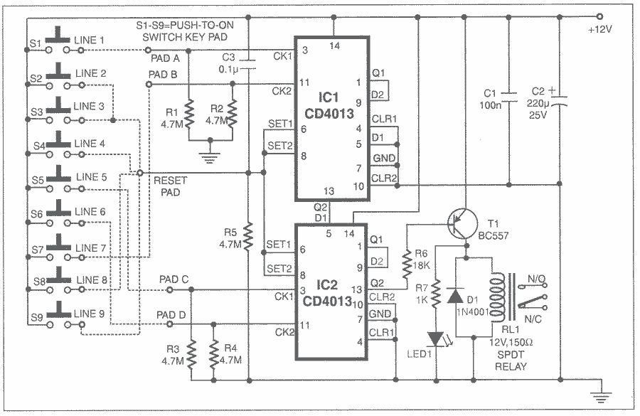

I need a circuit which will give me a simple 1 second pulse to energise a relay when a correct key code is entered on a small numeric keypad.
This circuit is being fitted to my track bike as i've no ignition barrel. So i want to enter a code which will then pulse a relay which i'll latch for my ignition then i'll have a kill switch which will break the latch !

google for an "electric combination lock" You can do it with some simple IC's (SR latch i think). You could also use a PIC microcontoller. alittle more complicated, but you could make it so that if you enter the wrong code it will make you wait a small amount of time before you can try again. You could take it one step further and make an increasing delay for wrong entries,

well if you wanna take all the fun out of designing your own circuit then I guess that will work...
how about this circuit?
