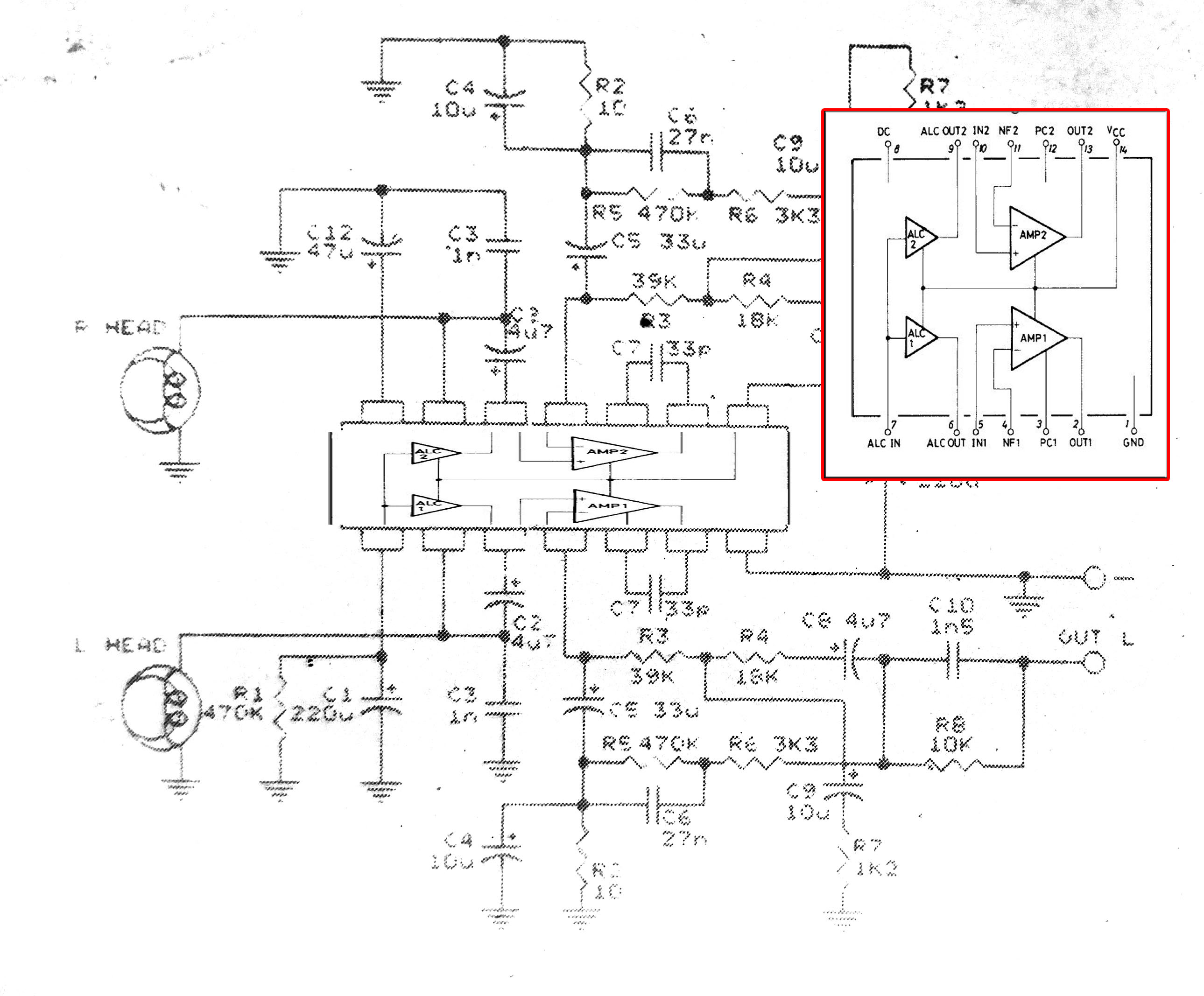

LA3220 Schematic electret pre-amp need help
H Jose's Dad!
Your circuit is missing the outputs from pin 2 and pin 13 and the negative feedback they deliver to pin 4 and pin 11.
The datasheet shows a 10pF capacitor added between pin 2 and pin 3 or between pin 12 and pin 13 to prevent high frequency oscillation when the gain is less than 100.

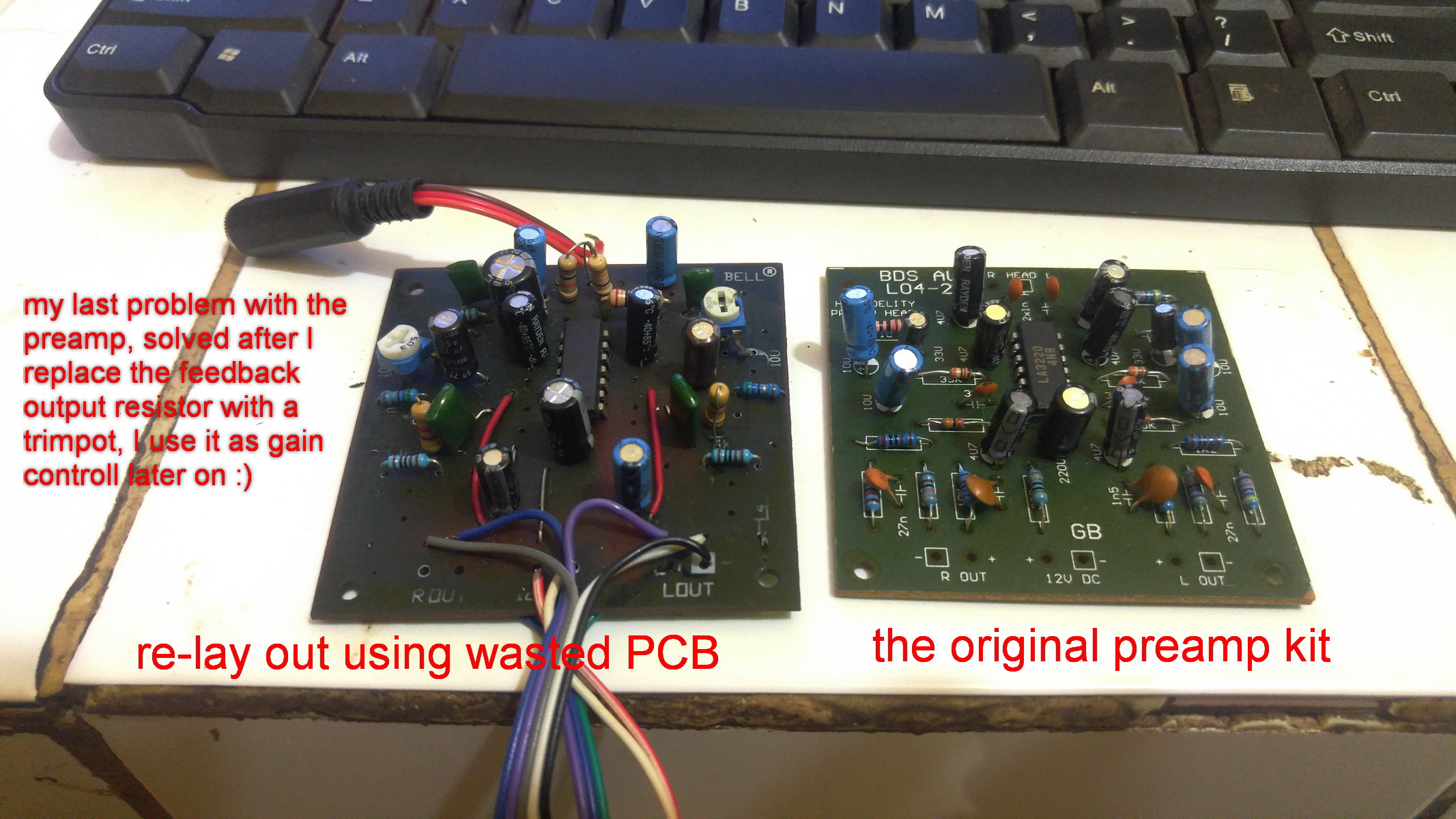

One month ago, before I started the project, actually I bought bunch NOS preamp head tape kit, and desoldered it and rebuild with your schematic with prototype pcb. After everything working nice, I go back to the wasted PCB that had been desoldered out, and I try to adapt the lay out with the new schematic. Its not easy but worth to try rather using prototyping pcb or make a new one. And I did it, not even cut any trace.
A weeks ago I study what really opamp is and how it works, Then I thought the head tape kit, must be a preamp too, why dont I use that preamp and tweaking it. it would be more efficient using the actual design rather than re design it. so I go back to the head pramp kit I bought before. Then I found the head tape preamp schematic different with the opamp theory I got ( I learn from Dave Jones EEV blog ). The last schematic I upload is from the actual head tape preamp I bought. After searching trough internet what inside LA3220 is, I found PC1 adn PC2 are connected to the output of the opamp. Its makes me confuse, I dont think that pin 3 and pin 12 is GND, since it on pin 1, right? But Im not sure.
this is my last works, using wasted PCB, the last schematic circuit is for the original preamp kit below

The schematic from the kit is completely wrong.

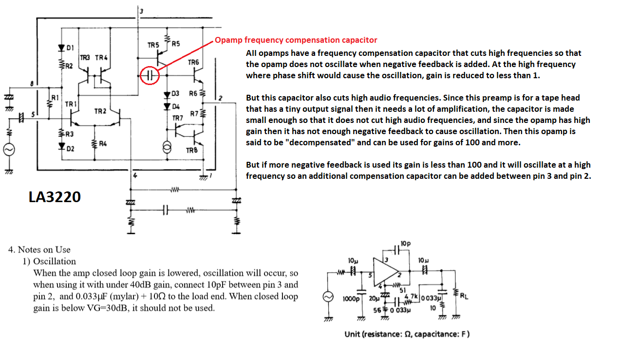

The LA3220 is a very old preamp made by Sanyo who are gone today (bought by Panasonic). In those days tape players were used and needed a lot of amplification. Opamps provide a lot of amplification but have phase shift that causes high frequency oscillation when negative feedback is added so all opamps have a "frequency compensation capacitor" to cut high frequency gain so that oscillation does not occur. The LA3220 preamp IC is designed with a small frequency compensation capacitor so that with a gain of more than 100 (40dB) then its audio frequency response is good and it does not oscillate. But when you use a gain less than 100 an additional frequency compensation capacitor can be added between pin 2 and pin 3 (or pin 12 and pin 13).
An NE5534 is another old audio opamp de-compensated for gains of 3 or more and an additional capacitor can be added for less gain.

Thank you for your clear explanation Audioguru. In your opinion what is the pros cons of this chip?

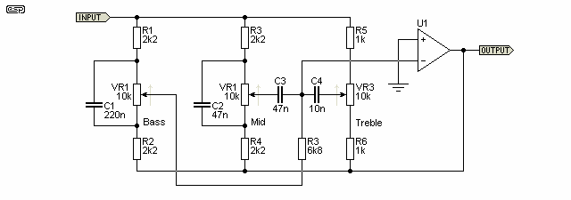

I plan to try to make a baxandal using another channel op-amp using rod elliot schematic. will it works?
You are welcome.
I would never use an LA3220 chip because it is very old, is not available anymore and needs an additional capacitor if you want medium gain. The datasheet says " When closed loop gain is below VG=30dB, it should not be used." Use a modern audio opamp like an OPA2134 that works perfectly with gain from 1 to hundreds without adding a capacitor.
I could not find Rod's tone controls circuit on his website. Please provide a link to it.
Its parts values are different to the 3-band tone controls circuit I have. Note that it must be fed from a very low impedance like the output of another opamp.

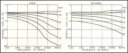

About 3 years ago I blamed "bad sound" on the video producer/directors for hiding the microphones too far away or under a thick sweater which made them sound muffled with no high frequencies. Then I had a free hearing test which showed that I had normal for my age severe high frequency hearing loss (I was 69). Then I got hearing aids that are programmed so that my hearing is the same as when I was young. The hearing aids do extra things that ordinary hearing cannot do like noise reduction, extra sensitivity, directionality, compression of loud sounds and muting when I want. They play telephone sounds in both ears.

Just as I thought before, You are as same age as my father. In my country, we give respect to the elder or senior expert by kissing his/her hand. So I send my kiss for your hand, sir. :happy::happy:. Your information about high frequency loss due aging give me another consideration, thanks you.
