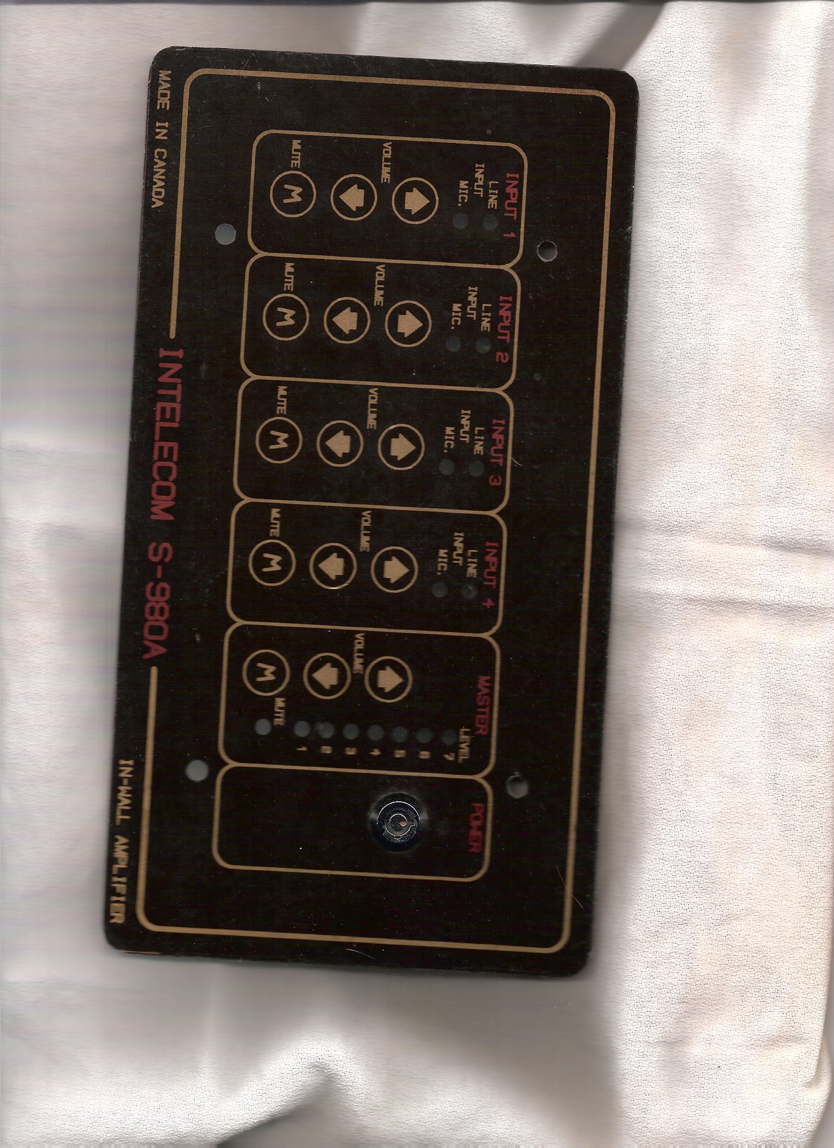

Here is what I do:
I do an overlay of the frontpanel in my pc-board program and take it to a photographic place to make a negative, imulsion side down (towards the support panel). The visible surface is cross-hatched with fine sandpaper to the desired texture and than satin laqured. The back areas are covered with masking tape, than spray-painted. This requires several steps if you use different colours. In the sample shown (a 4-gang American standard-sized electrical plate cover) we use gold and red (and unpainted for LEDs). The negative is attached with spray contact cement to the support plate.
This looks professional and we use a number of custom made pieces of test equipment with thes front-panels for over 15 years.
