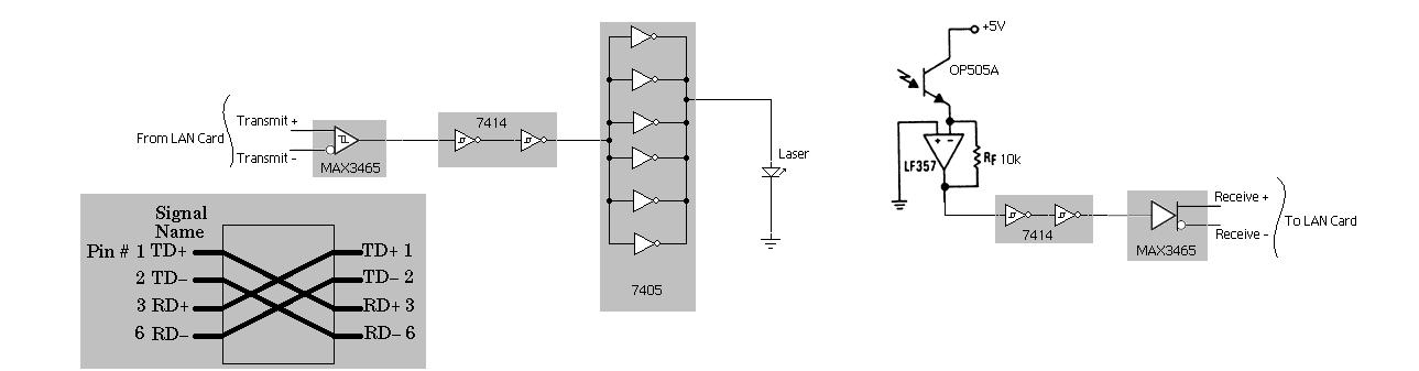

This is my view
i want to ask u that this circuit will work...
Data transfer rate 10Mbps,
Link for connecting two computers
Data sheet MAX3465
https://www.electro-tech-online.com/custompdfs/2006/09/MAX3465-MAX3469.pdf
Datasheet 7405
http://www.tranzistoare.ro/datasheets/185/500203_DS.pdf
Datasheet 7414
http://www.tranzistoare.ro/datasheets/400/334439_DS.pdf
OP505A
LF357
http://www.tranzistoare.ro/datasheets/270/64655_DS.pdf
If this circuit will not work then help me please to correct this circuit..
Tell me that what is wrong in this circuit.
How can i improve it's performance...
Tell me the good and high speed NPN phototransistor for Laser...
Thanks in advance...

How are you modulating the laser?, can it be modulated?, if it can, can it be modulated fast enough?. At the receiver side, all the same questions apply - except reversed.
Don't forget, Ethernet isn't a one way process - so you need a two way link as well - I've never tried, but I doubt Ethernet will work at all with just a one way path?.
What the modulation is necessary....
in my view it can be with out modulation... Am i right???
I know that Ethernet is a two way trafic... i will use two transmitters and two receivers... i mean one receiver and transmitter both side...
Exactly how will you be sending data if the laser is not moodulated in some way, shape, or form?
Data doesnt just magically flow down the bright light beam, and yes, it will need to be 2 way communication.
I do have to admit that your determination, and perseverence is good, but I also think that this may be a bit of a huge project to begin... with your current understanding of the theories involved.
The guys in the group are not trying to slow you down, or stop you from achieving your goals, they just have the past experience to realize that this is a bit too much for you to bite off...and may ultimately be a huge waste of your time.
If you are dead set on this project, at least try to copy as much stuff off of these guys as possible: http://ronja.twibright.com/ Go through their parts lists, heck use their circuits. It'll probably be a lot easier (and more likely) than getting a crash course equivalent to a 4 year college degree...

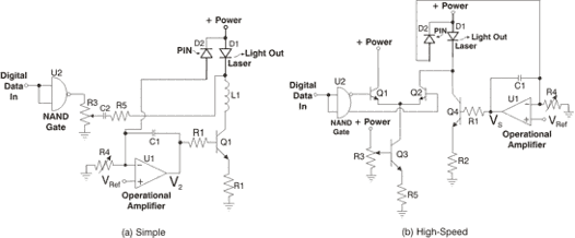

I'd suggest that a more reasonable option would be to make a serial link through the RS232 port, like 2400-57600 baud. That may be TOO simple though to get you a good grade.
As is obvious from the link, that's for sending data down a fibre-optic cable, notice that both circuits have a photodiode used to detect the output power of the laser diode!.
It doesn't have any relation to a laser pointer.
