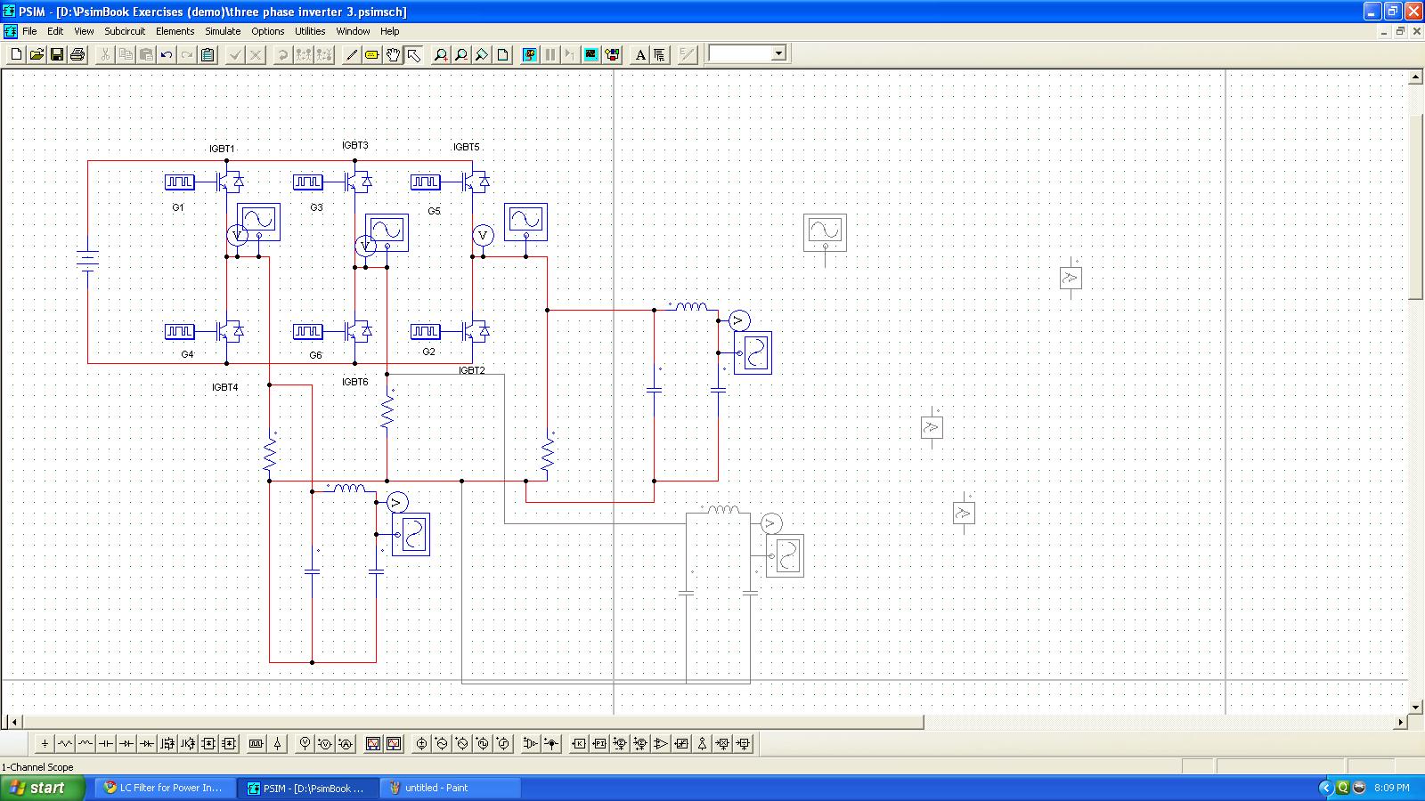

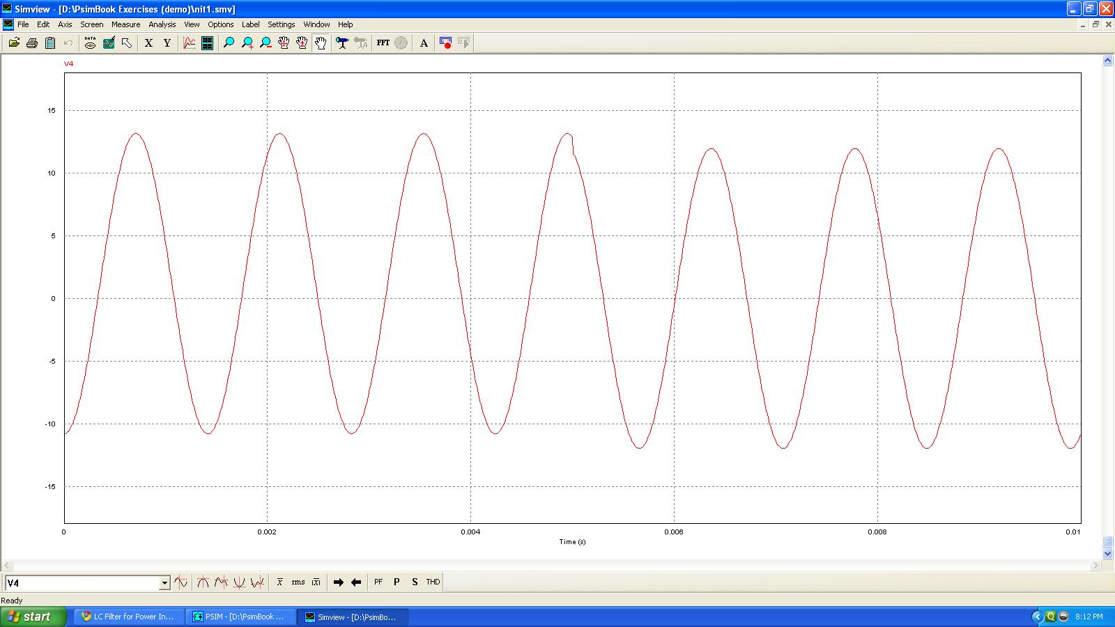

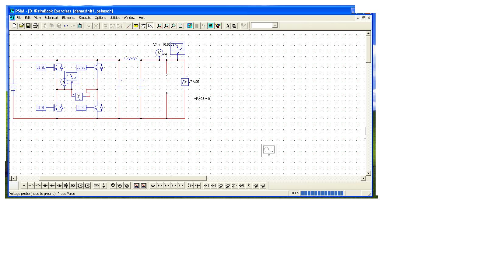

hi there
i too designed a inverter both the three phase and single phase using IGBT as a switching device. i searched in Google for an LC low pass filter design and i used the values i got in the design and i got the sinusoidal output.
but for three phase inverter i am getting uneven output up-to certain extent.
i am using powersim(PSIM) as software. i am using the demo version so i was unable to use all 3filters at a time for three phase inverter.
but i am got result for two phases which has some distortion
data: 24v input;65hz frequency for IGBT;
butterworth LC low pass filter
L : 15915uH(inductance)
cutoff frequency: 1Khz;output impedance:50 ohms
c1=c2=3183100pF(capacitance). how should i reduce distortion.pls help me
i am sending the circuits which i have simulated and the outputs of them which may be useful....
regards from
nitish.k
