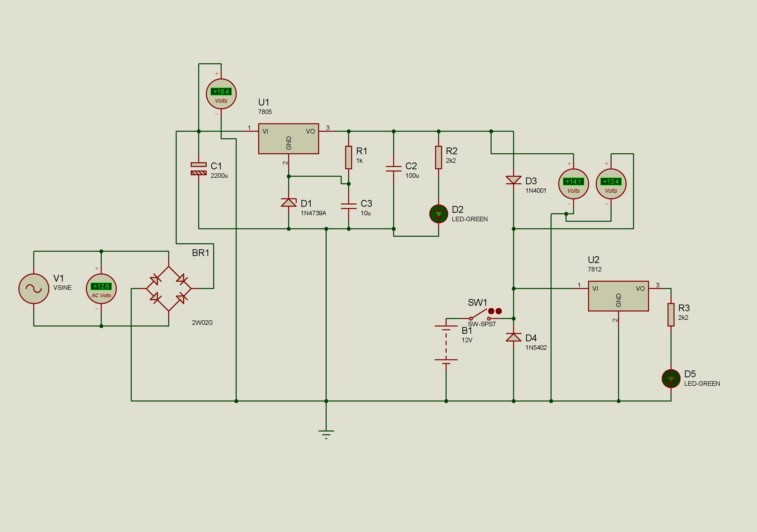

i also doing this kind of charger
View attachment battrey..pdf
this is the battery datasheet im using ! ny charger output is 13.29v do it possible to charge the battery in this state?

Don't ask the same question more than once.
Looks like two separate applications to me. One is for a line powered charging system and the other is for an automotive powered charging system.
Do you think?
The schematics look identical to me.
I looked at the other thread first and saw the AC input on the schematic and assumed he was referring to using a line powered system possibly for charging whatever it is at home.
Then I saw the title of this thread referring to a car and assumed that he was also needing a charging method that worked in his vehicle as well.
This is what happens when people dont elaborate on what they want or are trying to do! :(
We all start making assumptions and taking guesses.
