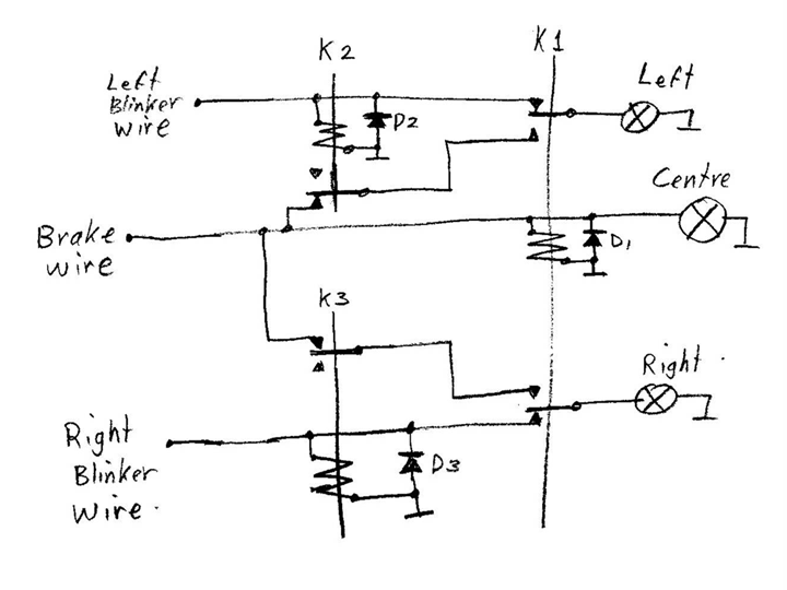

What the OP needs to buy is one of those adapters for connecting trailer lights to a car. Or he can make his own with a couple of relays:
The first design relies on the tow vehicle's existing light bulbs to provide a current path for the relays. The second circuit is a little more complex, but is better suited for the OP's application.

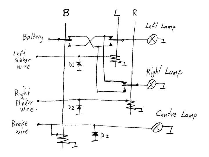

I could not open the first link posted by kchriste.
The second one only has two lights on the trailer. The Op needs 3.
So here is my suggestion. The relay contacts are connected in the exclusive OR configuration. Thus if a blinker only is required, the respective relay blinks and energises the respective lamp.
If the brakes are applied, all 3 lamps glow.
If the brakes are applied and say the left blinker is selected, the left lamp blinks and the other 2 glow continuously.
Diodes D1 ~3 protect the switches from the back EMF of the relay coils, ie. the diodes clamp the back EMF to about 0.7 Volt.
Virtually any diode can be used, it only has to withstand is the coil current when the switch is opened.
I have assumed that the bike has a negative ground. If it has a + gnd, then reverse the diodes.

I have now studied the second link posted by kchriste in more detail.
It can be altered to include the brake lamp and has an advantage over the one I posted above as it does not need the battery connection.
So I have attached it re-drawn so that even I can understand it.
I've added diodes to protect the switches as before. Again, reverse the diodes if the bike has a + gnd.

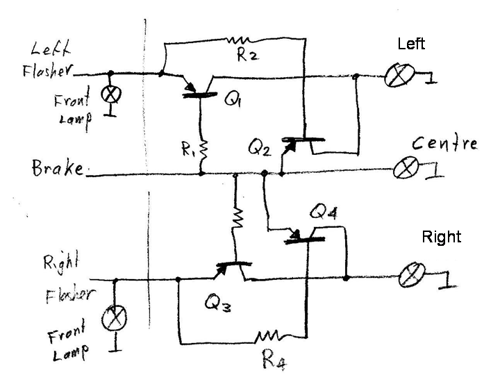

Here is an electronic option that occured to me last night.
It assumes that the bike has a negative gnd. If not, then NPN transistors would be required.
It also needs incadescent flasher lamps at the front to provide a path for the transistor base currents.
When the brake is applied, Q2 turns on via R2 & the left front flasher and Q4 turns on via R4 & the Right front flasher. Thus all three lamps glow
If say the left flasher is switched on while the brakes are on, Q2 is turned off while the flashing voltage is on, thus the left lamp flashes.
If say the left flasher is selected without the brakes, Q1 is turned on via R1 & the Centre lamp when the flasher voltage is on.
