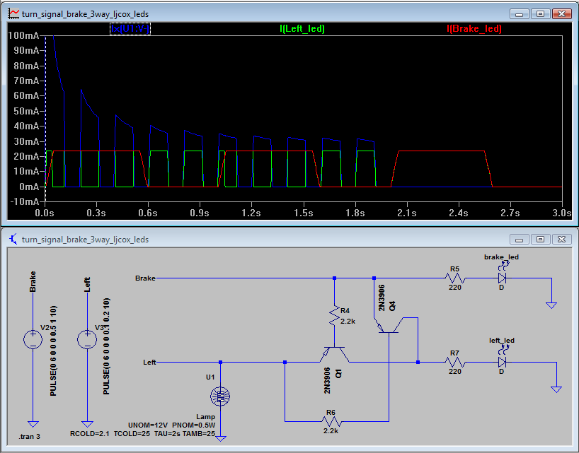

Oddly enough it works with LEDs now without the proposed parallel resistors, which means either A) I screwed up earlier, or B) I'm screwing up now.
Attached is an image of what I have for the LEDs on this right now. I'm only including one side here. In this version I have an incandescent lamp on the front flasher and an LED on the rear. It works just the same without the front flasher present, or with an LED in front instead of the lamp.
The sim seems to be doing exactly what I would want, and from what I (think I) know, what I would expect.
I'm confused about why the transistors wouldn't be getting current. Aren't the base resistors doing that?
Anyway, the brake (red line) is pressed 3 times slowly and the left flasher is on until 2/3 of the way through the simulation. Time is greatly compressed here. The rear flasher inverts when the brake changes state but flashes just fine.
Torben
[Edit: The lamp wattage and supply voltages in the image don't match my above explanation but I just changed them back to 12V and 6W and got my expected results. The lamp current line now evens out at 0.5A.]

Torben,
I was a bit confused when I wrote the previous post. I was confusing the transistor on and off criteria.
If all the lamps are LEDs, then there may not be a problem.
If you look at the voltage on the brake line, you will see that it rises to about the LED voltage (if it's a red LED, it will be probably about 1.7 Volt) when Q1 is on.
So the base current is going through the brake LED.
There won't be a problem provided that the current is low enough so that LED does not glow AND the transistor has enough base current to saturate it.
But I'm not sure if both of these criteria can be met.
It is usual to make the base current about one tenth of the collector current in order to ensure that the transistor is saturated.
Can we meet this criterion and not cause the LED to glow?
EDIT
There will be more than one LED in the lamp. So it will also depend upon how many LEDs there are in series. With a 6 Volt system, you could probably have 3 LEDs in series.
If there are 3 in series, this will significantly reduce the base current.
So a resistor in parallel may be necessary.
Hi Len,
OK, I built the thing. I didn't really get what you were on about above until I did--not your fault; I just needed to see it in action. The sim is nice but doesn't really help explain it. Getting the build wrong a few times, thinking about it, etc., helped.
I couldn't get the base current to shut off the flasher LED when the brake and flasher were both HIGH until I added a resistor to ground from the Left brake line input. If I'm doing this right, that means this resistor is dissipating 120nA when the left flasher is on. Seems acceptable.
I haven't tried driving a front flasher from it yet though, and this circuit on the board is just a very simple exploration: 2 PNPs, 5 resistors, and some wire. :)
Anyway, thanks very much for the patient explanation. I think I'm getting what's going on in the circuit now. Perhaps I'll build one for a high brake/flasher on my truck canopy. Someday. I won't be using 3906s though.
Torben
[Edit: nb: This was an all-LED build, one LED per side. Just to check the basic idea before proceeding.]
[Edit 2: I added 2 more LEDs per side. These are all normal 20mA garden-variety red LEDs. It works fine as long as the voltage doesn't sag. At all. ;) ]

Oh dear. I can see why you're confused. I posted complete gibberish.
I meant "left flasher line", not "left brake line".
And I meant that the new resistor to ground would pass 120uA (see below for why 120 is wrong too), not dissipate it. The nA thing was just me counting zeroes wrong, I guess. The resistor to ground is 100k. I got a bit confused because I did the calculation on paper first for 6V, got 60uA, and then simmed it and got 120uA, which confused me until I remembered that the sim was running 12V, not 6V like my breadboard. Then when I posted I just read the value off the sim instead of my paper. Argh. So that value should really be 60uA for a 6V supply, not 120nA.
I must try to remember to post *before* falling asleep. Apologies.
The schematic is the same as the one I posted earlier (the LTSpice image with the graph) except the front incandescent lamp model has been replaced with a 100k resistor.
Torben

Torben said:
Actually, it works fine in the sim without the resistor, but in real life it needed the resistor there to cause the transistor to block the current to the flasher LED when the flasher line went high. I assume you mean the case where both the brake and flasher lines are high. If the F is high and the B is low, the flasher LED should glow. Otherwise, when the brake line was high both LEDs would light up (as they should), but when the flasher line would then go high, the flasher LED would not turn all the way off. This does not make sense to me. When the F line is high, the resistor should have no effect. It is only has an effect when the F line is low - since it tends to pull the line low if the F line is (without the resistor) going from open to High. With the 100k grounding resistor there, it worked perfectly.
Not sure why, but the sim doesn't seem to care whether it's there or not. See below.
Torben
In the sim case, the voltage source driving the F line goes from low to high. When it is low, the F line is at 0 Volt. But in the real case, I assume that the F line is going from open to High (as I said above) hence there is no path for the current when it is open.
However, I still can't explain what you're observing. I'll need to think some more about it.
I still can't make any sense of it. So I've drawn the attachement.
Please measure the voltages (without the 100 k resistor) at the C, B & E of both transistors for each case.
A point that just occurred to me is the that EB junctions will go into Zener breakdown if the supply is 12 Volt. And it may occur at 6 Volt.
Yep, that's the truth table I've been working from too. This truth table matches the exhibited behaviour when I have the 100k resistor in place.
I'll have to measure them later tonight but I'll do it.
Torben
