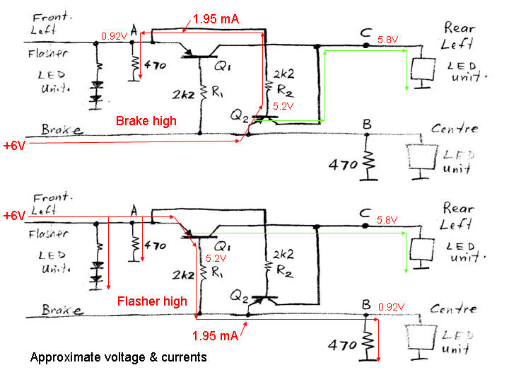

Torben,
I'm confused by your descriptions. I feel we may be talking at cross purposes. So I'll try to clear the air.
If you look at my diagram; if the Brake line is high and the flasher line is low, current should flow from the Brake line, though the emitter of Q2 to the base, then via R2 (the 2.2k) through the "Front Lamp" to gnd.
If the "Front Lamp" is a LED, there will be insufficient base current since the LED represents a very high resistance. That is why you need a 470 Ohm resistor in parallel with it.
The lamp I marked as "Left" on the right hand side of my drawing (ie. the rear brake/flasher) does not need a 470 in parallel.

Torben,
Yes, I eventually came to the conclusion that there was a "crossing of wires" as your resposes were not making much sense.
The attachment shows the approximate voltages and currents for 2 cases.
1. with the Brake line high.
2. with the Flasher line high.
If the front flashers are incadescent, then the 470 resistors are not required.
I have not indicated the LED currents as I don't know what you used. But with a base current of about 1.95 mA, the collector will be able to source at least 20 mA with the transistor still in saturation.
EDIT. The exception to the above is that if the centre lamp is a LED one, then it will need a 470 in parallel.

Len,
Yes, I'm glad that is was simply a misunderstanding. I can deal with learning that I may need to be more clear in my questions. I was not happy thinking that everything I thought I'd learned about transistors up to this point was wrong. :)
It is now clear. Once again, thanks for the persistence! This must have been agonizing.
Torben
No problem. As someone once said, a picture is worth a thousand words.
Verbal descriptions are often not precise enough.
