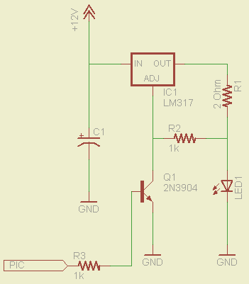

I am makeing a circuit that controls the brightness of high power leds through PWM, I have come up with this circuit to power the leds and to let the arduino PWM the grounds... any suggestions that i need to do to it? and ideas what transistor i need to use? i am pretty sure my math is right as to what the current values should be
led1: 625mA
led2: 625mA
led3: 625mA
led4, 5, 6: 312mA
Not a good way of doing it. First, the NPNs are sinking ~0.6A, so they will need a base current of ~60mA, which the uC cannot source. Also, the Dissipation in the LM317s will be huge; they will need to be on huge heatsinks...
I would use an NFET for the switch. By moving the current-limiting resistor into the source, the NFET can do double-duty by limiting the LED current at the same time.
What is the Vdd for the uC? What is the forward voltage for the LEDs at 0.6A? At 0.3A?
You could instead place a resistor between the ADJ and R1, then use a small transistor to pull the ADJ pin to ground.
Doing so would drop the output to 1.2v. effectively turning it off.

Also, as MikeMl has stated, the regulators will dissipate a lot of heat.

ok so what your saying is to get rid of the 317's all together put a series resistor inline with the 12v source and put the nfet between the led and ground? Like this? If it is like this what nfet would you recommend or will any one do?

Not quite. I would make the NFET a "constant-current sink" by putting a suitable resistor in the source lead.

The uC's vdd is 5v, as for led's 1-3 the forward voltage is given for 0.7A so so i am going to assume that is close enough.

You might look at the NTD4856. The price is right and you wouldn't need a heatsink. It will also switch at 5 volts if that is the micro output. Don't forget to calculate the power in the resistor and the LED. The downside is it is not constant current.
