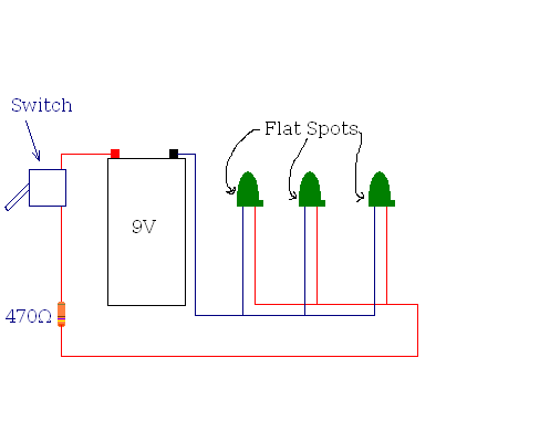

I have attached a REAL diagram of this. I tested it, and it works great!
Those LED's are in parallel, not series.
I'm sure it does work, but from a design point of view whats the best way and why?
Series or parallel LED's ?
-edit can't spell parallel
Yeah, i know that it is in parallel. I too would like to know, parallel or series? Series would use less material (wire, solder), but parallel looks cooler. :) If you would like, i could redraw it? :cool:
StopGo said:
Those LED's are in paralell, not series.
Series or paralell LED's ?
You should NEVER parallel LED's - as they won't share the current equally. If you must put them in parallel, you need to give each it's own series resistor.
Ok so manufacturing differences result in slightly different voltage drops at a given current. In parallel LED's the LED with the lowest voltage drop clamps the other LED's to the same voltage drop, no doubt there will be a range of different currents flowing through each LED.
In Series, the same current flows through each LED but the voltage drops can be different.
Ok so power output by each LED is V*I
Parallel LEDs : constant V, variable I
Series LEDs : constant I, variable V
Is one really better than the other ? Why ?
Yes, because series works, and parallel doesn't! (it blows the LED's), even if it works initially they will tend to have a far shorter lifespan - it's bad practice, DON'T DO IT! - don't even THINK about doing it!.

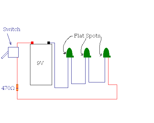

Ok, here are the changes.
Some of are still waiting to learn of what the painting is of, that you are cheesing up!
Yes, do tell! :) (probably putting RED LEDs in the Mona Lisa!)
The current is much lower with the LEDs in series. Re-calculate the value of the current-limiting resistor.
