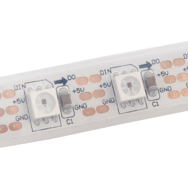

I see each horse as one strip.
https://www.sparkfun.com/products/12028
There are many different type of strip lights.
This type of light come in any length. Each LED can be set to any color and brightness.
Watch what some one did with music and LED strips.

Note that some Led strips have 3 LEDs per chip and aren't individually addressable.
I didn't know that. I watched some YouTube videos about Neopixels. Is it possible to set a single color for each string? Thanks

If you go with neopixel, make sure you get a microcontroller that has the speed needed to control the neopixel. The neopixels are kind of a pain in the ass with slower Microcontrollers. An Arduino Teensy seems to be the best from my experience. The 3-wire system of neopixel means the chips have their own clock and off pixels and on pixels are set by carefully timed pulse trains.
The "DotStar" LEDs are slightly more expensive but have a fourth pin so the clock is set by the arduino instead of trying to match the clock speed of the arduino+neopixel. Arduino libraries exist for both styles of light strips.
Each can also be cut and wires added to space them apart as you wish.
