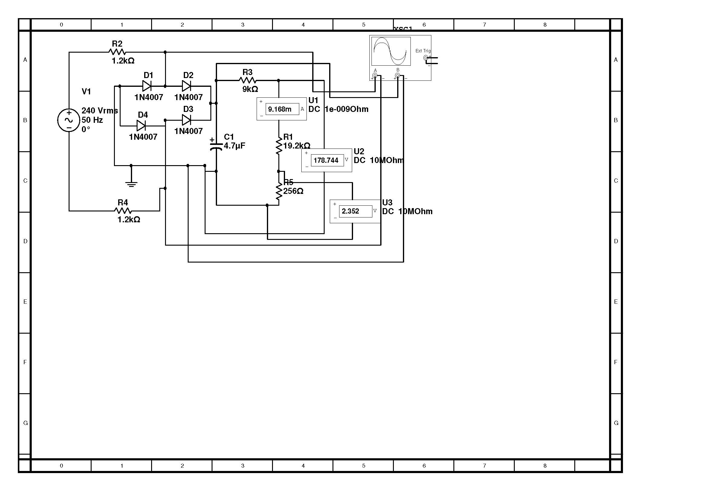

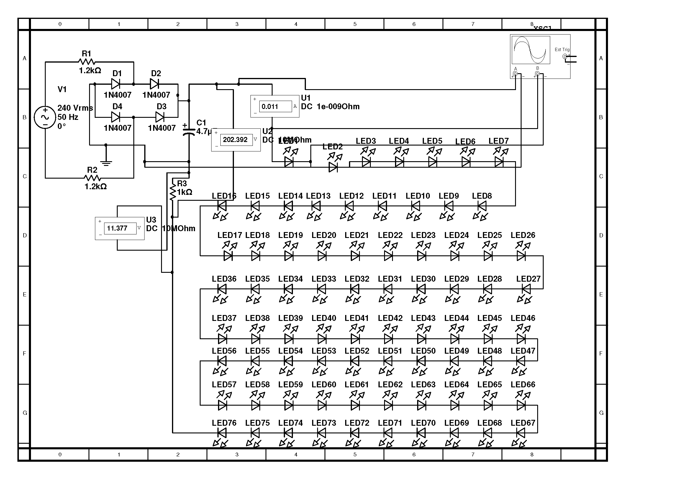

But what about the schematics I posted 5 posts up, are they ok like that?

there you go. Pngs this time.

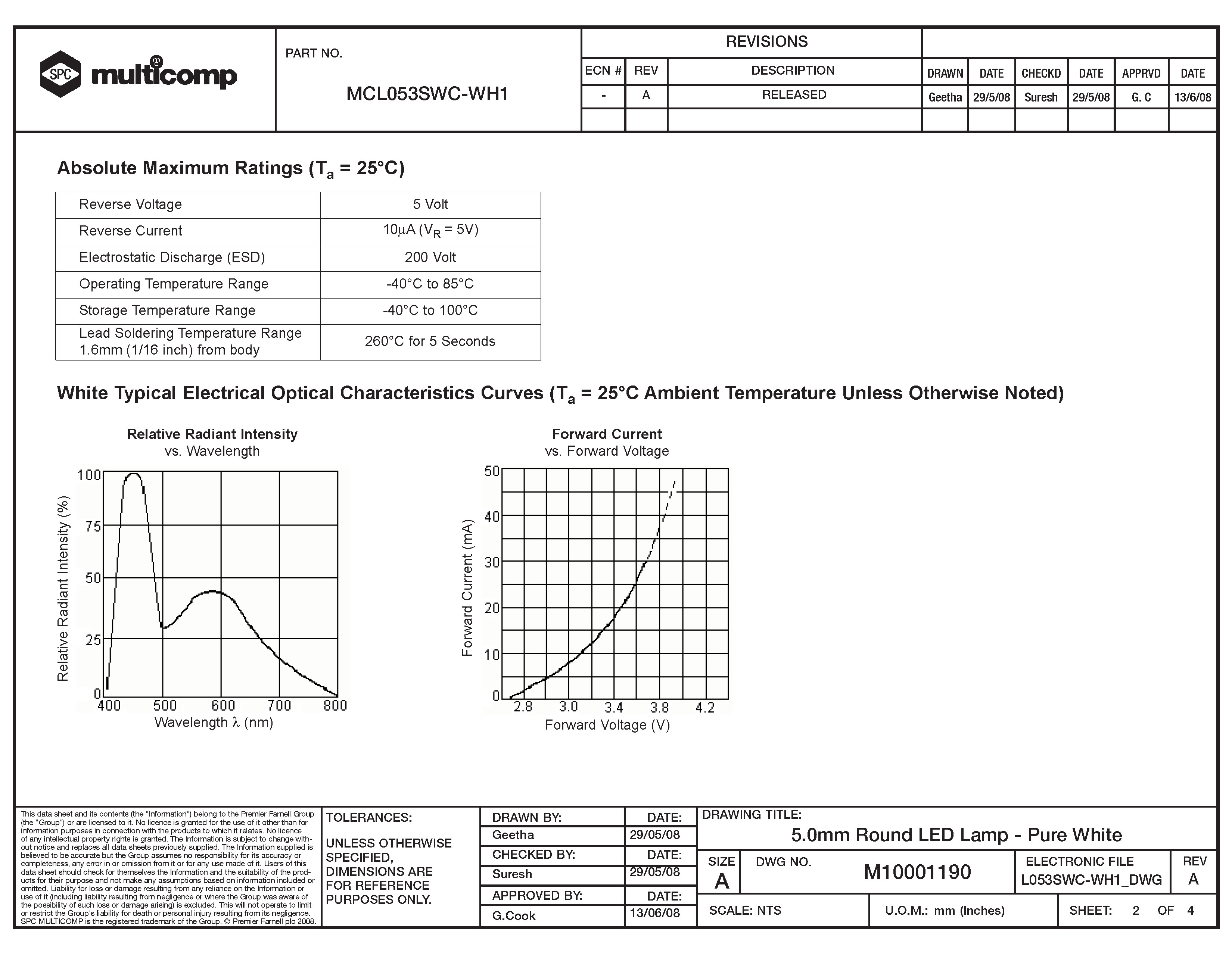

Did simulation with 76 LEDs, set their properties to 11mA and Vf 3.1V instead 5mA/1.66V.
The other simulation is LEDs replaced as resistor, aiming at 2.3V (would be 3.1 V/sqrt 2)?
The other is just the bit of data sheet with a graph current over voltage, so you could determine resistance at a certain voltage.
