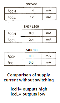

I made circuits with LS all the time until I switched to Cmos. LS was fast and had a much lower supply current than ordinary TTL.
But Cmos can't be beat for low power consumption at low speeds:
