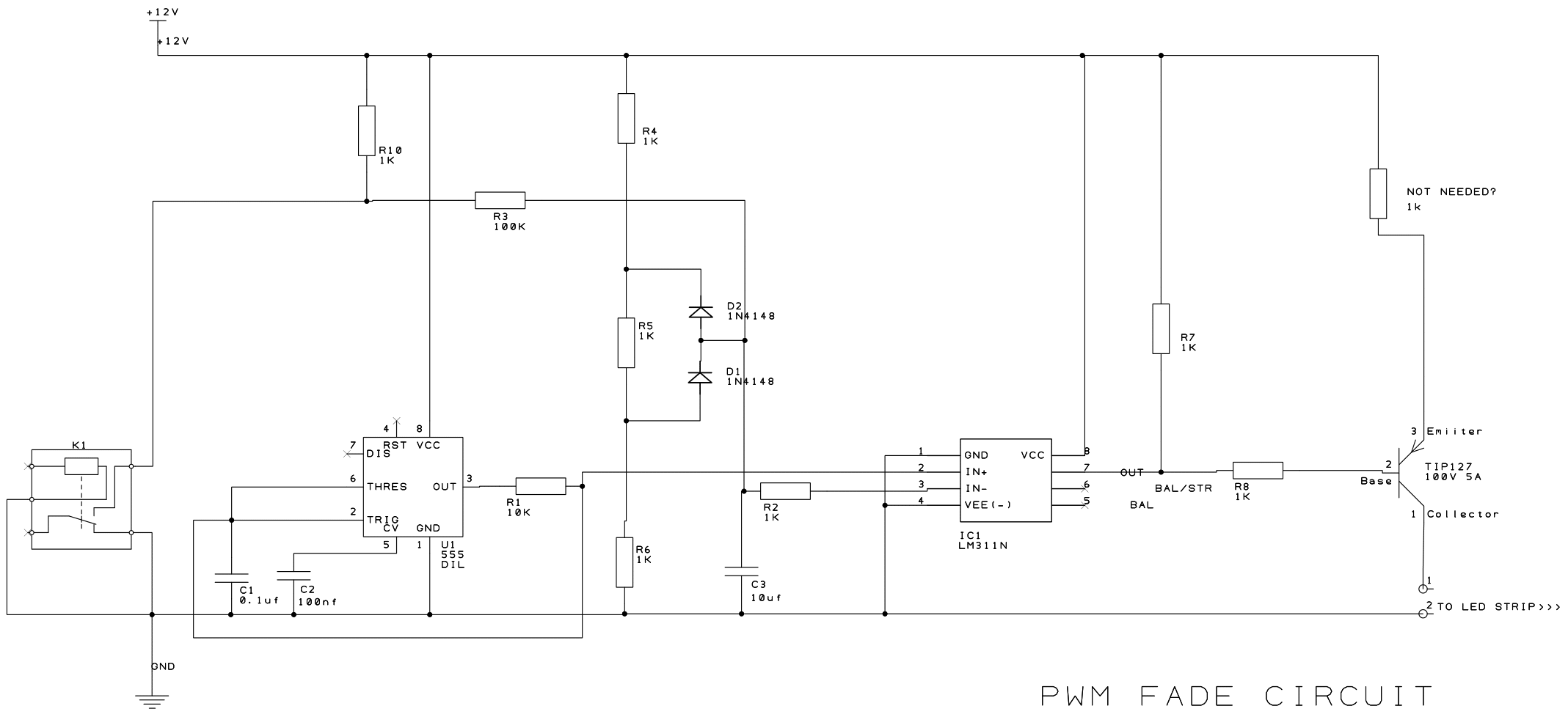

LED Strip lights (2 Amps) Short Fade on / Fade Off effect
Thank you. I will look into using PWM.
What are the values of R2 and R1
R1=100 ohm, R2=500 ohm
I cannot get TIP121 (supplier has only 1 TIP120) but I see a comparable part is TIP122. The voltage is higher. I think that means the additional voltage in 122 will burn even hotter than the tip121
It will run hot with either transistor, but not because of the voltage rating your referring to.

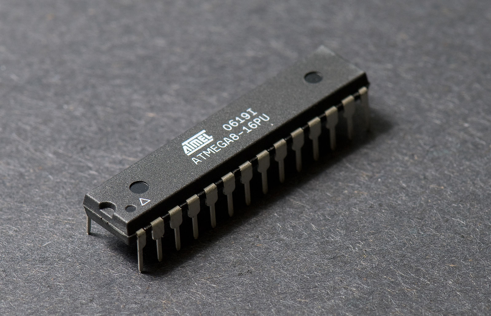

Or, you simply buy the AVR chip, you can either buy them with the bootloader ready loaded, or use an Arduino to program the bootloader in to a blank chip.
Now this is interesting. This is how I believed it should work. Create, test, compile, then export to an AVR chip and insert this in your circuit thus being able to reuse your adrino for future projects.
Pretty well, although you would usually do all the development on the Arduino board, and only transfer it to an external chip once it's fully debugged.
Although you can certainly program a processor and transfer it to a target board for testing, which was how I used PIC's for years, until ICSP became commonplace. I used a parallel port programmer (and WinPicProg software to drive it), which had a ZIF socket fitted, making it easy to program the PIC's.

The PWM frequency is also set far too low, just so the change in duty cycle is visible in the simulation; C1 should be 0.1uF or lower to eliminate flicker.
The frequency being set too low would have what affect on the circuit?
I understand flicker. C1 0.1uF I've got them.
I can see by the blue line that the fade is 1 second. Thats just fine.
I will set Q1 to the same darlington as in eTechs design TIP122 as it was suggested that this NPN was suited for a PWM.
I'll connect the (+) of the LED strip to the emitter of TIP122
Confirming the switch is a positive (high) latch. Ill connect my circuits output (triggered relay) to SWITCH1 of this circuit.
Thank you so much for your time.
T.B.
The light would visibly strobe on and off during the fade period.
If you want the fade a bit longer, just make C3 a bit bit bigger.
The switching would be more efficient with the load in the transistor collector, rather than emitter; there will be less output using emitter follower mode,
If the LED lamp must be grounded, you could swap the output device to PNP and reverse the +/- signal inputs to the comparator, so "off" is high.

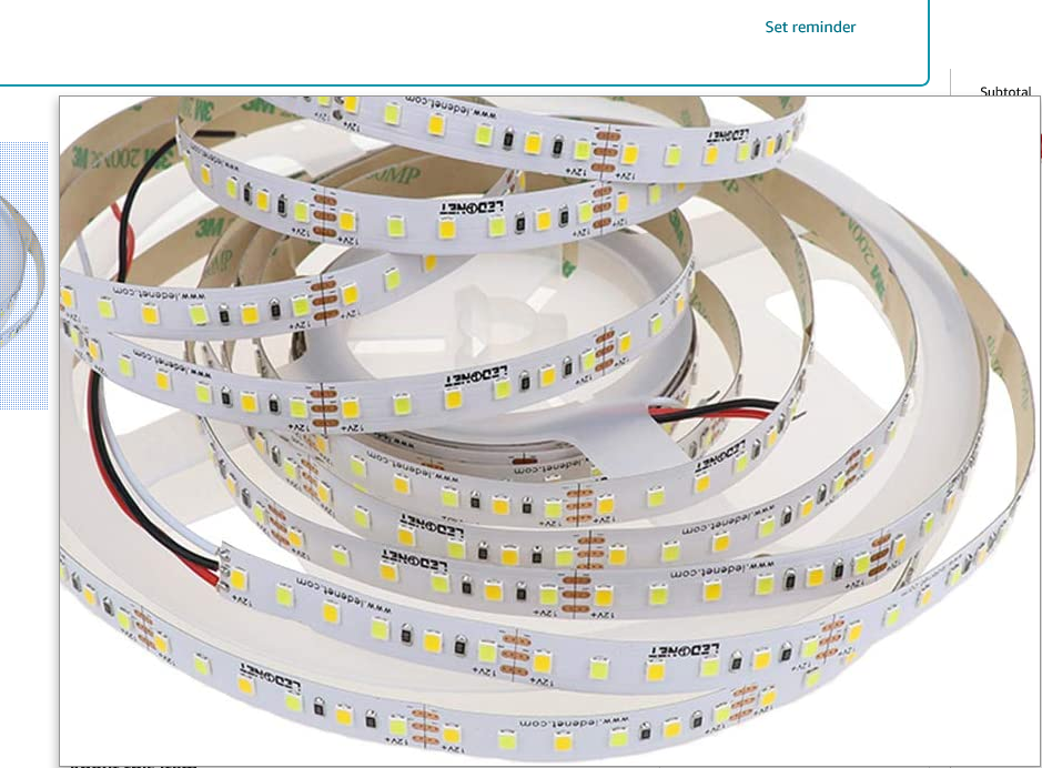

This is the led strip i use. They can vary from amps and wattage but im using about a third of this roll. apx 2amps. and yes there are positive and negative leads so it will be connected to ground. if thats what you meant by grounded.
In my original circuit the relay completes the ground. When I noticed your PWM circuit was triggered by a positive switch I adjusted my circuit so the relay completes the positive. If its possible to trigger your circuit with a negative latch that would better suit my circuit. Will using a PNP accomplish that? It doesnt appear that its that simple but i could be wrong.
If you want it "on" when a switch to ground closes, swap the switch and R10, so the input to R3 is high for off and low for on.
Then either swap the + & - inputs to the comparator, or use a PNP output transistor (with load to ground).

I'll draw up a schematic and post it.
Ok I made the corrections you suggested. I normally do not get this right so if I did ill be surprised. :D
Update C1
PNP transistor TIP127
Relocated R10 and R3
I dont think Resistor to Emitter is needed.

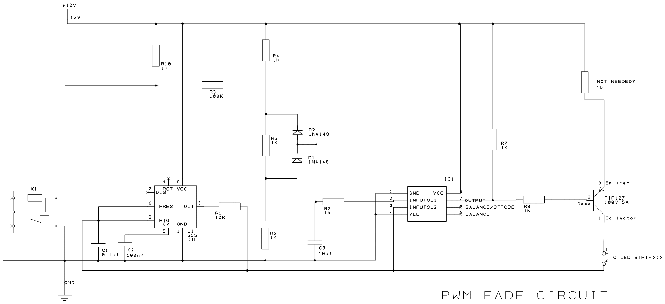

UPDATE:
I mi-staked the trigger on the 555 for a ground. fixed.
Also forgot to reverse LM311 IN+ & IN-
