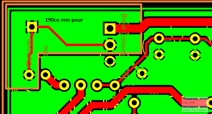

The only place where beefy traces are needed is at the collector and emitter of the Darlington transistor, as well as the PWR input.
Emitter is probably connected to the ground plane, so that's good. But the collector track is carrying alot of current so should be wide. The PWR track from the power input (wherever that is) to the light could be a small copper plane on the top side.
Ive since moved components around. I needed the NPN on the side. I added this small pour from the collector to the lights output pin. The PWR track that went to the lights positive pin was not needed as this circuit is a negative (low) switch so it was removed. My question is this. The method i added the pour planes. I first added a full GND plane indicated by the 4 black arrows. then i drew a smaller pour plane in the top left and assigned to the collectors net. JUST TO BE SURE I DID THIS CORRECTLY. I could take it further and reduce the size of that track, add the pour, adjust the spokes (there will be only 1) from 12 to 20.

If the collector pin pad and the light terminal pin pad are on the same net, and they are thru hole pins, and you used a pour to connect them together on the top side, then there shouldn't be a trace between them on the top. The pour should be solid area with thermals (wide - 4-spoke thermal) located at each pad. There seems to be a red trace making the same connections but splitting the pour...:confused:
The grounded side of the power NPN should be connected to the ground pour (top and bottom) with thermals.
I have found that its fine to draw pours over top of one another. Just to be sure they are applied in order.
This is how it looks now. Yes your right about the trace not supposed to be there. It is hidden and only there visually if i click it.
Ive rearranged the component to improve the number of spokes on the collector pin (2) and i have 6 on the output pin.
Here are both pours. Top only. If i add the bottom GND pour it will be difficult to see. I resized the pad on the base pin from 70 to 65 and it was enough to get 4 spokes on the collector pin. The emitter pin has 3 spokes.
Really, there's no real reason to add more, or less, spokes than 4. Remember what you are trying to accomplish with this small pour.
It's to provide a large amount of copper connectivity to the pad. Basically, the pour becomes the "wire". Adding more spokes removes copper and increases resistance. While the pads do need thermal relief, its better to stick with 4-spokes and make them wider (remember the reason for wide tracks in the first place).

I did not realize that it worked that way. "Adding more spokes removes copper and increases resistance." I take it the spokes are not copper but another metal. The color being the same as the pour led me to believe they were the same hence the more spokes the better. Im glad i asked. Ill manually remove two spokes from the other pad. Reason i could not get the four on the collector pad without increasing the layout to six.
The spoke IS copper and are part of the pour. The "gaps" between the spokes "thermally" isolate the pad from the pour while the spokes maintain electrical conductivity between the pad and the pour. Each spoke is a "track" and passes current just like any other track. Therefore, with regard to electrical current, it has the same attributes. A thinner spoke has higher resistance and resists current flow, while a wider spoke has less resistance and will allow more current flow. You also want to keep the spokes evenly distributed around the pad so that heat is evenly distributed.
If you have trouble with clearances, I think there is a setting in the pour dialog.
If you have time, create a small project with a PCB, place some parts and play with the pours and clearance settings. You'll see how they affect how well the pour forms around tracks, pads, and thermal reliefs. The clearance settings are very inportant to know how to use.
Your correct. I narrowed the isolation gap by just 1 pt and it added all the spokes evenly around the pad.

Hi. I have crunched more number and performed a few tests. As i mentioned before the listed current draw and wattage was different from what i measured so there may be a chance i do not need the additional copper if i can widen the right tracks. Hopefully then i can avoid the $17.00 up-charge for the 2oz copper.
Ive added a pour from the collector to the output pin. The shape is not a rectangle but its area equals 190 cubic mm.
Every light with exception of 2 of them draw .5amps of current. The temp of the Darlington increases 14-15 degreesF under this load. Would you agree that the darlington is good for loads under .5 amps?
The other two draw 1amp each. The darlingtom reaches 99F under this load. I personally would use a mosfet for these circuits if not to only reduce the heat dissipation but for the knowledge i have gained from your assistance. (I actually thought a FET and a mosFET were the same thing) My question for these 1amp loads is what tracks would i need to increase to meet the goal necessary?

Could you identify the pins (C B E) for the darlington NPN?
Looks like the pins might be swapped in error.

The 40 thou tracks were OK for around 2.5A if I remember right? No problem for 1A.
If there is a pour, that part will stand rather higher current.
ps. I believe you mean square millimetres, not cubic!
