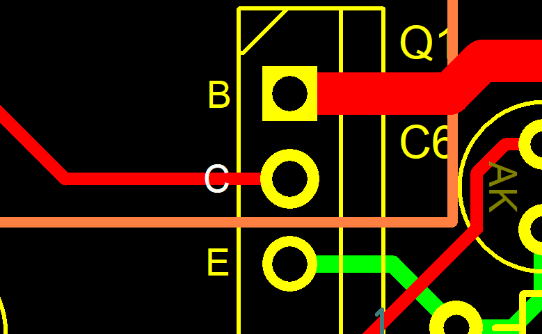

Could you identify the pins (C B E) for the darlington NPN?
in post #118 you can see there are 6 spokes. it was the only way (at this time) that i could get enough spokes around the collector. The emitter still has three on the top pour but gains a fourth on the bottom pour.
Hmmm....is this an NPN as low side switch? I don't remember what the schematic showed.
If so, the highest current will be passing thru the collector (connected to the light) and emitter (connected to GND) of the darlinton transistor. So, I would expect that the emitter would be a thermal pad connected to the ground pour, and the collector would be a thermal pad connected to a isolated pour that includes a light terminal pin thermal pad. The base pin doesn't need to be very wide since it doesn't need to carry much current because the darlington transistor has an enormous amount of gain.
yes it is.
Yes. That is absolutely what i have done.

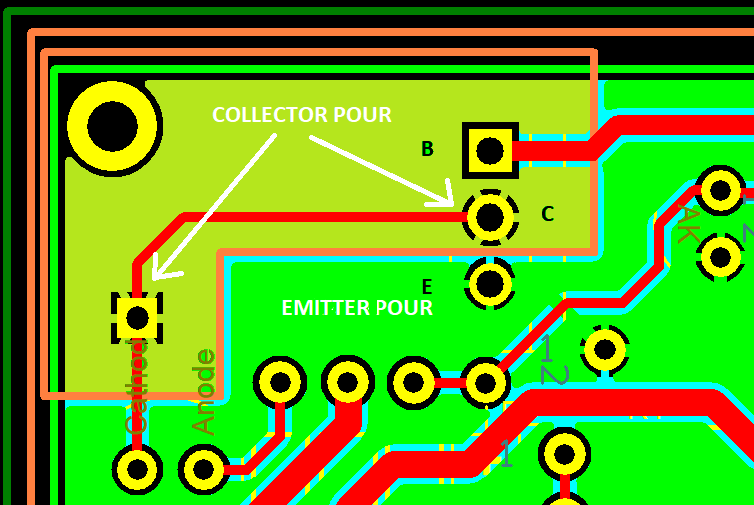

make the red track wider.
Im going to try to look this up but i believe any existing track, regardless of its width becomes part of the pour. So if you are referring to the thin track from the collector to the pin, i purposely reduced its size so it would not negate the purpose of the spokes. but i did make them wider for the entire board. default 10, now at 16. And I extended the collector pour area to include the LED.
Overall I feel great about this project. Ive learned a great deal about pours, spokes, and a wee bit about current.
Collector pour = yellow
Top GND pour = green
Bottom GND pour = blue
Base track width is 30
For future reference...you can create your own custom Thermal pad with wide spokes so you don't have to manually widen the them.
I have found this in the pour settings. As of now I can only make settings per project. While it comes in handy for temporary adjustments on pads for a component things like net track widths are per project. But for now I don't mind.
