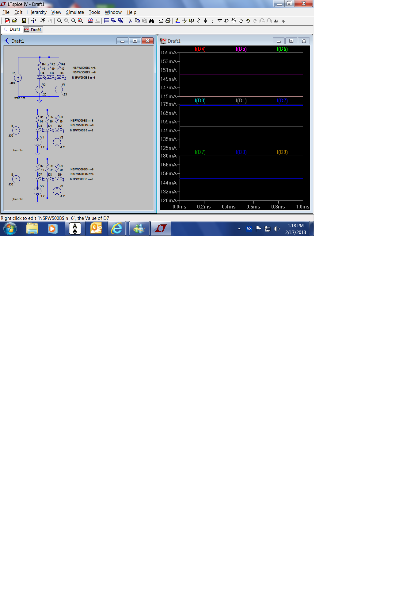

Here is an example of what might happen with 3 different methods.
Note: It does not include what might happen with temperature. par leds.png
thanks ronv, but that is low current, presumably below or at the knee.....higher up the curve and current changes drastically with tiny changes in Vf
