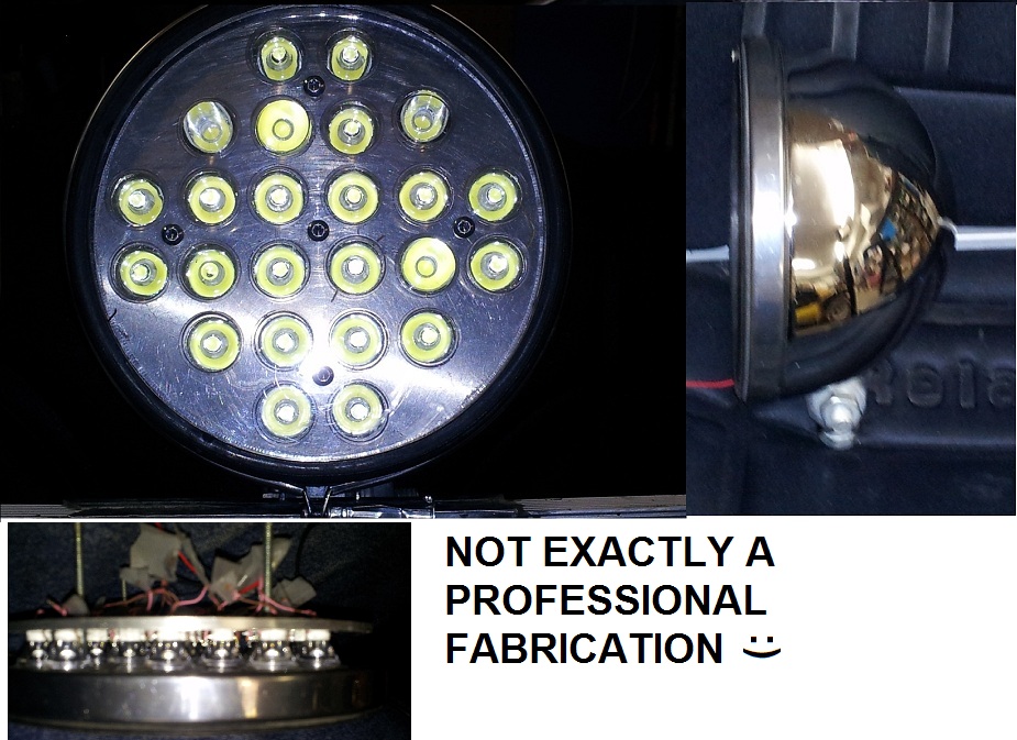

The 3 watt LEDs I'm using are rated at 3.6V a string of 4 would be rated at 14.4, my max voltage is 14.2, I'm just running them slightly under specs, none of that other stuff, I'm messing around at home with these and I like the 3 watt LED because of the available lenses for them. 24 LED Light.jpg
I guess what I'm saying if that if you take 500 3.6 volt LEDs and run the in parallel at 3.5 volts, they should work fine, just not as bright as they would at 3.6, I'm getting away with running them at 3.55v/LED, maybe it is just luck, but they work!!! :), But I think I need a better heat sink, even with a fan inside that shell, there is no way I can get rid of all that heat.
No.
A zener diode has a voltage spec, an LED has a range of voltage. Your "3.6V" LEDs might be 3.2V (very bright and will burn out soon) or 4.0V and be dim or will not light.
You say potautoe, I say potato, I still have 12 strings of 4 3 watt LEDs with no resistor on my vehicle that light up when the power is applied, dim slightly when engine is off or idle and brighten up as the engine revs up and one over my bench that take a bit more abuse because it is well heat sinked and fan cooled.
The fact that the brightness changes with a change in voltage tells me that there is something in the system with resistive characteristics. There may not be an actual 'resistor' but there is parasitic resistance in the PCB traces and other interconnects. And due to the temperature coefficient of copper, the resistance grows quite a bit when the system gets hot.
Even a few tenths of an ohm can be enough to balance strings of LEDs that start out closely, but not perfectly, matched.
That's what I have been saying using the term "soft knee", white LEDs have quite a large range of voltage where they go from zero current to max current, in a lot of ways they behave like there is a small series resistance in the LED itself.
Some of that might be the little gold leadwires inside the package giving significant resistance, especially with higher current LEDs. Some might be deliberately designed into LEDs designed for lighting use, although that's just speculation.
What Ever! the reason for the dimming is the alternator puts out 14.1 volts when a little bit above idle and when the engine is off, the battery puts out 13.6 and decays from there until I start the engine again and the alternator is running every thing with the higher voltage.
Because I was concerned about heat, I put the light on my work bench and powered it up with 14.1 volts, measured at the plug with a Fluke, and inserted a thermocouple inside the light and let it run for around an hour with a 4" muffin fan blowing air across the light from about 2 feet away, the heat got up to almost 90° C, so I put it back on the vehicle.
