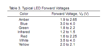

audioguru is talking nonsense, you can get LEDs with buit-in resistors so i can't see why you can't get them with inbuilt current regulators.
It's easy to make a current regulator, just tie a JUGFET's gate to its source and the manufacturer could easilly integrate this into the same package as the LED.
Hi Eric,

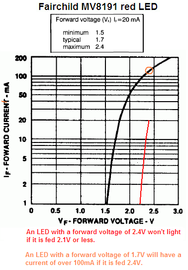

You posted a list of the standard typical forward voltage range of ordinary LEDs that need a current-limiting resistor added. Tese ordinary LEDs do not have a constant current source because their voltage range is the same as ordinary LEDs that do not have a constsnt current source.
Here is a graph showing an ordinary red LED and what happens if it does not have a current-limiting device.
Hi Eric,
hi agu,
I posted that small chart of conventional LED's, as part of the ongoing discussion, for reference only.
I appreciate that standard LED's will not stand a lot of abuse, I have used them a 'zillion' ways on 'zillions of projects.:)
The easy way, is to use a low cost pnp transistor, a bog standard diode and a couple of resistors and make a 15mA CC source.
It will drive the full colour spectrum of LED's quite happily from 12V thru 30v.
