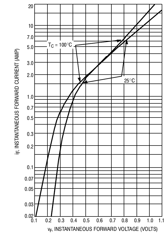

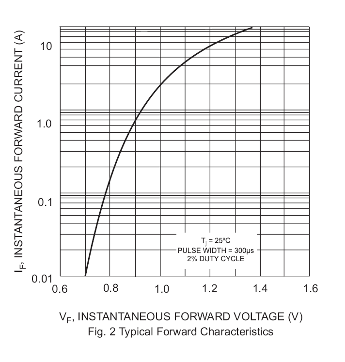

@audioguru and saturn1bguy
The curves mean a lot. I get it. Do not apply ohms law to semiconductors. :D
One more question. I am trying to understand how we rectify current with voltages many times that shown in the Vf If curves.
Suppose I build a bridge rectifier from 1N4001's and hook it to 12 VAC. I then regulate the DC down and hook it to a 200mA load. For kicks lets say the regulator eats another 50mA for a total of 300mA. The diodes will be operating past the Vf max on the graphs pass only the current required by the load If the load goes too high the diodes die.
Is that the way it works?
When the AC voltage is near the peak voltage then the rectifier conducts with a current of up to 30A. At 30A its forward voltage is about 2.0V and the rectified output voltage becomes 2.0V less than the peak voltage of the AC.
The anode voltage rises with the AC signal rising and the cathode voltage follows it at up to 2V less.
No.
The forward biased diodes follow the AC voltage. The max forward voltage of a 1N4001 is 2.0V at 30A when it quickly charges a big filter capacitor. In your circuit the diode might not have more peak current than only 3A then its max forward voltage is only 1.0V.

I'm not positive what you're asking, but:
There is no Vfmax, only Ifmax and Vrrm, which for a 1N4001 is 1A and 50V, respectively, as I recall. The diodes blocks below Vf, and do what you want when they're above Vf. As long as each diode doesn't draw more than an amp, or have to block more than 50Vp (35VAC), you're okay. (They don't graph Vf more than they do because If, the max allowed current, has already been shown. Meaning it's of no use to plot Vf more than shown because the diode has likely already died from too much If.)
