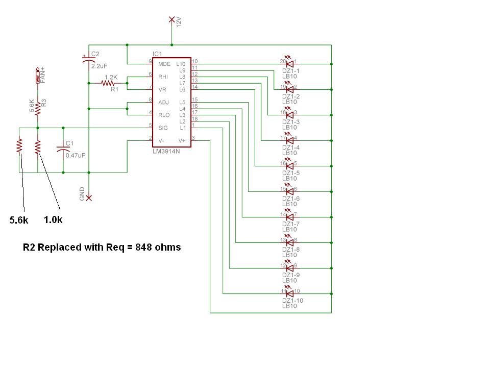

Here is an image of the modified LM3914 circuit. I changed the voltage divider a bit so the LEDs light up completely at about 10V instead of 12. If I would have left it, all but 2 LEDs would light up, since my fan controller allows voltages of 1.25 to about 10.2V.

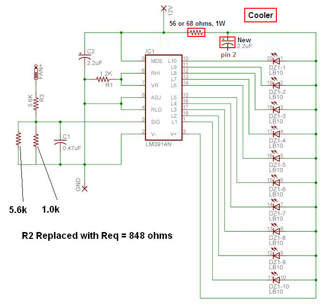

Hi Dark,
Your LM3914 circuit is correct. :lol:
With 12V as its power supply and 1.7V red LEDs it will get hot when all 10 LEDs are lighted:
1) The 1.2k resistor sets the current of each LED to 10.4mA each x 10= 104mA for them all.
2) The voltage across the outputs of the LM3914 is 12V-1.7V= 10.3V.
3) The power dissipation of the LM3914 is 104mA x 10.3V= 1.07W.
4) The datasheet says the LM3914 heats 55 degrees C per watt so if the ambieint temp is 30 degrees then the internal temp is (55 x 1.07)+30= 89 degrees C. It will be hotter if it is sealed in a box and the LM317's will also heat the box. Its max temp is rated at 100 degrees C.
The LM3914 will operate much cooler if you add a power resistor and another capacitor like in my sketch.
You shouldn't parallel voltage regulators since they fight each other. You should use the correct regulator:
An LM317 is rated at 1A but some of them can supply 1.5A. It reduces its max current by reducing its max output voltage as it heats.
I suspect that one fan is too much current for your single LM317 so it reduced its output when it heated.
Why not use the correct regulators? An LM350 is rated for 3A and an LM338 is rated for 5A. The pins and circuits are the same as an LM317. :lol:

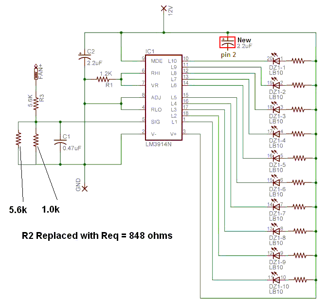

First, determine how much current or wattage each LED can handle. The packaging should have the answer.
Next, determine the MAXIMUM voltage you intend to use.
Now, use ohms law to find the lowest value resistor you could possibly use for your design.
Use ohms law again to find the minimum wattage your resistor must handle. If you select a resistor that can't handle the wattage, then it may heat up, and the value can change, producing unpredictable results, most likely against your favours.
now for each LED, you will connect a resistor (as calculated above) in series with it.
It is better to do it this way than to have +ve connected to all the anodes through a resistor, because the brightness of the LEDS will be more consistent, no matter how many are on.
You will notice what I mean when you begin to deal with about 15+ LED's.
EDIT: take a look at the attachment.
I had to convert it to gif, because bitmap was not accepted, and it seems that takeone 4 (my graphics editor) has a colour bug in it, so some colours will look a bit off. Colour is irrelevant.
The unmarked resistors are the ones that need to be calculated using ohms law.
If you are lazy, you can usually get away with 1K.
and that resistor audioguru highlighted is not of a benefit. If it is supposed to benefit the capacitor, connect them both in series.
The resistor he added does the job of the ten you added!, thus saving 90% of the cost!.

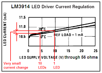

MStechca,
Look on the datasheet of the LM3914 and you will see that it has current regulation for its outputs. The amount of current is determined by the resistor R1 in this circuit, 10.4ma for each output.
As I said before without my added resistor, when all 10 LEDs are lighted the total current is 104mA and the IC will have 10.3V across its outputs resulting in a power dissipation of 1.07W.
With the 56 ohm resistor added in series with the supply for the LEDs then the 104mA will cause a 5.8V drop across it and the outputs of the LM3914 will have 10.3V-5.8V= 4.5V which is still plenty to drive each LED at 10.4mA but the power dissipation of the IC is reduced to 468mW.
Since the IC has current regulated outputs then each LED will be the same brightness when their supply voltage is changed by my added cooling resistor.

I did some testing and checking last night. It looks as though the LM3914 circuit was built just fine. I built it at the same time as the other one that works properly. I honestly think I have a faulty LM3914. I placed an order for one online and I will replace it when it comes in. Good thing I used a socket!
The LED's are appearing and disappearing more irratically now.
It would make a LOT of sense if the LM3914 was faulty too. A while ago I got a new 10 element LED because the top bar miraculously stopped working. Note that this was on solderless breadboard, and everything else worked properly.
A new 10 element LED bar fixed the problem. It is possible that the cool down time allowed everything to work, and the LED not lighting up wasn't a related to the actual LED itself at all.
Come to think of it, I had a few mishaps during the testing phase of the circuit. I even cause a capacitor to smoke and burn out because I goofed. It is possible that the LM3914 was damaged during this process.

mstechca said:
Let's ignore the IC for the moment, and assume the outputs were converted to ground.
I don't like the fact of the LED's hogging power from one measly little resistor. My method is more like a "power sharing" method.
Ohms law can greatly help here as well.
It shouldn't matter as long as the resistor is capable of dissipating the power though, right?

If the outputs were connected to ground, then your solution of ten resistors would be the correct one - however, as we've mentioned repeatedly in other threads, IC's don't work in that way. In this case it's even less so, because the IC is designed specifically to drive LED's, and doesn't require series resistors for them. Audioguru's single resistor is simply to reduce the voltage to the chip, to keep it's dissipation within it's limits - it doesn't set the LED current as normal resistors would (and neither would your ten).
Ohms law is incredibly useful (and should be tattooed on the back of all babies hands immediately after birth :lol: ), but you have to know where it applies, and where it doesn't - as a very crude generalisation it applies to passive devices (like resistors) and NOT active devices like transistors and IC's.

Hi Dark,
The resistor and capacitor that I added to your circuit don't affect the operation in any way. They just reduce the power in the IC and allow it to be cooler by letting the resistor share the power dissipation. I spec'd the resistor at 1W so it doesn't get too hot.
MStechca,
Look again at the graph I posted. The outputs of the LM3914 have current regulation. The LEDs don't need current-limiting resistors because each output automatically adjusts to hold the current at 10.4mA. The circuit is set so each output is regulated at 10.4mA and their currents are identical so they have perfect "power sharing". The resistor I added shares the total power that would be dissipated in the current regulator transistors.
Transistors used as current regulators don't saturate, so you can't think their outputs are grounded.
