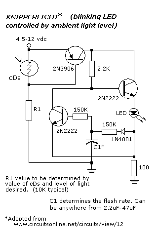

I use Microsoft Paint program for schematics. The one I posted uses parts copied and pasted from another schematic and then I moved the parts around.
Yeah, me too. It's very easy. The copy and paste feature keeps all component parts identical in a schematic.
(Sample attached)
nope no drawing programs other then a cad type deal called sketchup but its more 3d type drawing!!
i'm looking at the sheet and the drawing(the first one from len. to see how the math works !
