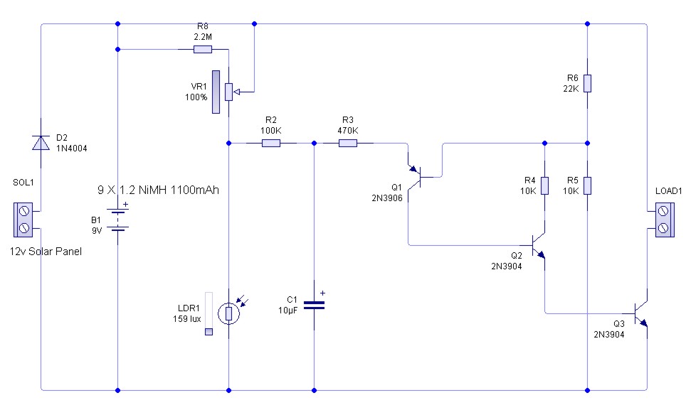

Search for 'dark activated switch', plenty on the web. I built on a while back for a solar garden light, LDR and 2 transistors. No idea where to look for the schematic right now, maybe after work.

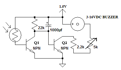

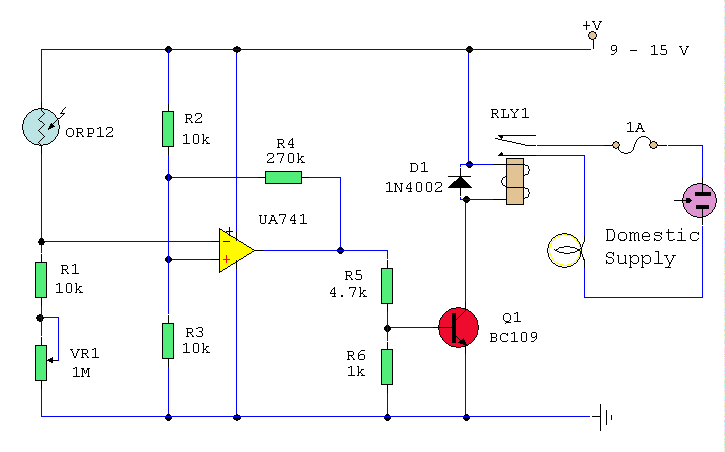

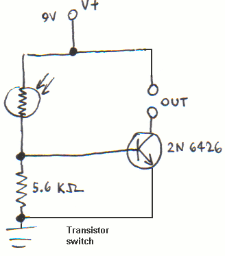

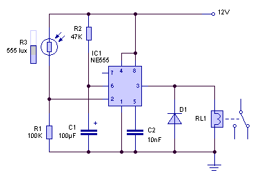

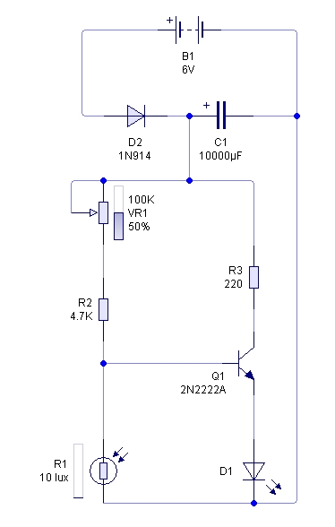

There likely a dozen different ways to do it. Here are a couple I found still on the computer, not the one I was looking for though.
Well, went a little crazy and dug up some more, most untested....
1 transistor
3 transistors
555
741
Quite a variety. I know you are interested in PIC, so didn't include my AVR work (still kind of buggy), but uses a red LED as the detector and the AVR's analog comparator.
