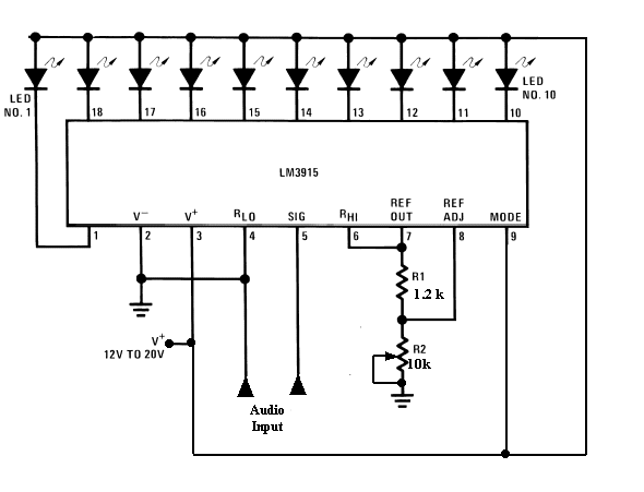

Hello all, Ok, so i'm making a VU meter for a stereo system.

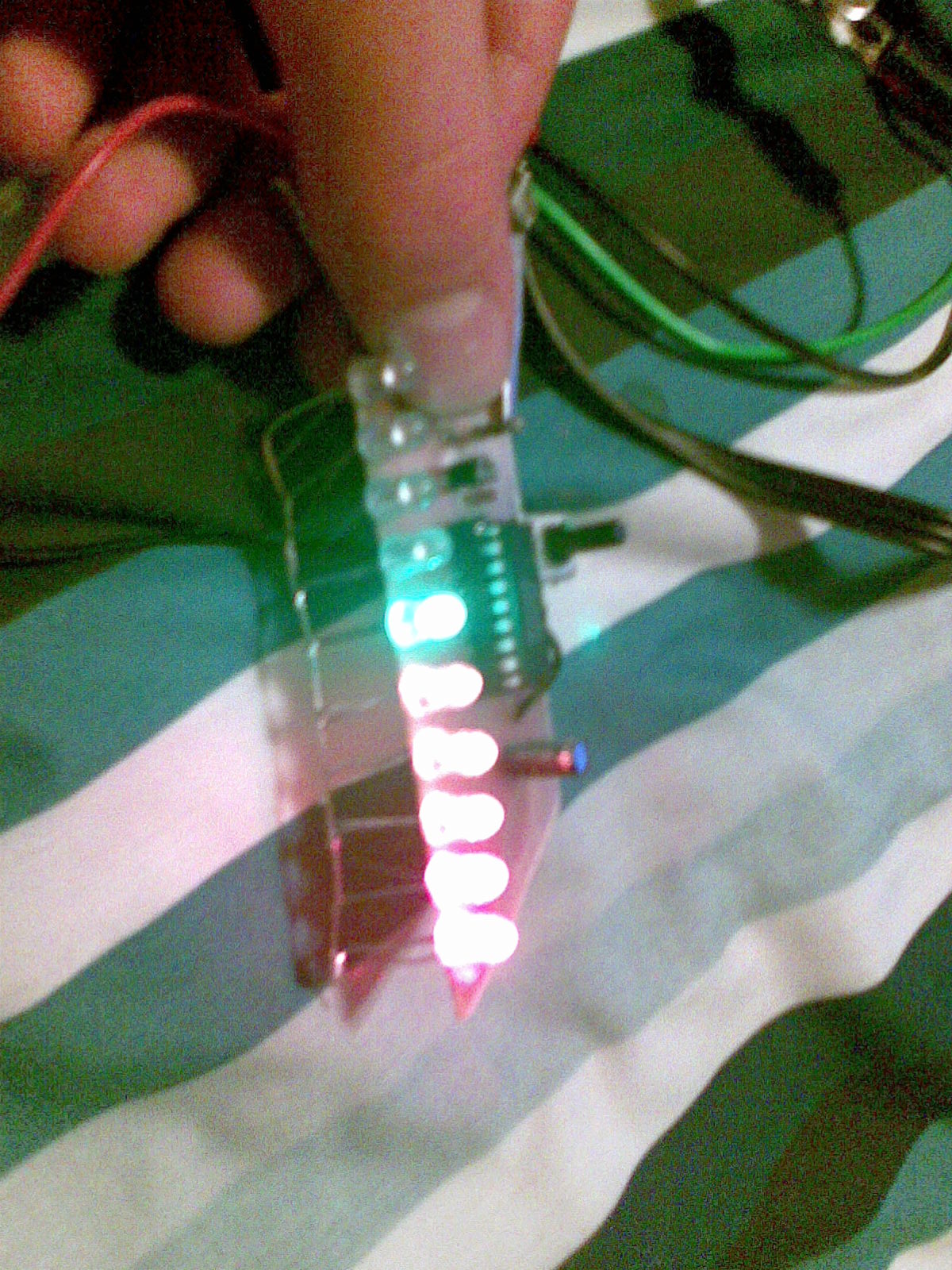

I just bought an LM3915 Log driver as it was reccomended to me on this forum. However, the LEDs are nowhere near responsive enough. It seems life the sound input "cant make the LEDs move" (sound input is good, though).
Only the LED on the end of the lit up string is mimicing the music beat.

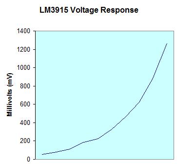

Being logarithmic, the input power must double every time to light a new LED, correct?
I have the circuit working fine, and I've adjusted all the controls - it's the chip that I dont think is what I'm after.
Is the LM3914 what I need?
EDIT: I used the attached circuit.

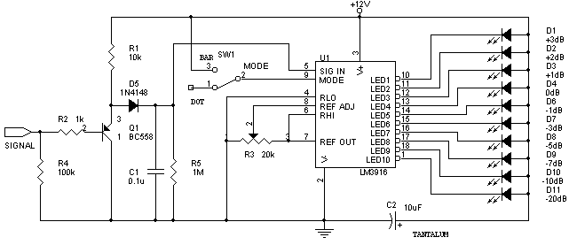

yes: heres what i did (its a pot)
|==- positive (12v)
|==->to signal input>
|==- GND
I then measured the voltage at the signal in pin
yes- every LED works fine and well. Did you see the youtube videos? you can see how un-responsive mine is. I powered the VU meter straight off my (cheap crappy) 1W stereo at full power. The point is, all it did was turn the higher up LEDs on, with exactly the same un-responsiveness.
Any ideas?

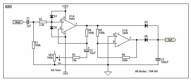

You mean this circuit here? can I substitute the 1458's with OPA opamps (Ti's audio op-amps)?
And, can I use a 12-V-12 supply instead of the 15-v-15 one listed?
Also, what do the marking near the pot mean? ("CW")
I'll give this circuit a go when I have the time, and I'll let you know what transpires.

Audio guru suggested using a full wave peak detector.Data sheet suggests as well.
Look at the data sheet for the 3915 figure 4
hopefully all the data sheets are similar but there is a schematic of this circuit.
it might help?

The transistor peak detector circuit you have works well only if its input has a DC path to ground. Your lower LEDs are always lighted so your headphones output probably has a DC voltage on it.
Adding an input coupling capacitor to your circuit will fix it. Try a 1uF non-polarized capacitor.
Your 20k pot has two functions:
1) With it turned to ground then the input sensitivity to light the top LED is 1.25V peak. The LEDs will be extremely dimmed.
2) With the pot turned to max then the input sensitivity is horrible. The top LED lights with an input of about 10V peak but the LEDs will be brighter.
Remove the 20k pot and replace it with a 1k ohms resistor from pins 6 and 7 to ground. Connect pins 4 and 8 to ground. Then the sensitivity is 1.25V peak and the LEDs will be pretty bright.
You won't see any difference between half-wave and full-wave with music or speech.
