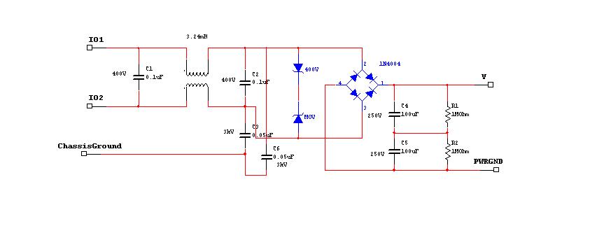

Alright, Ive been reading around for a bit, but now Im stuck. Ive designed my PSU to be 15V, 10Amps. Ive calculated pretty much everything, but now Im stuck on which Controller to get. I Used 90VAC to 130VAC as My Input Voltage (I want it to plug into the wall..). I have everything calculated around that, however I am finding that most controllers have a Max Input of 40V DC. Ive seen the circuit they use in the book (see attached Circuit)
On one circuit they have 900uH for the Inductors and 150uF for the output caps (same circuit, just those 2 things are different). The book doesnt explain what the circuit does. Does it Regulate the Input voltage for the Controller? Or is it a safety thing?
BTW, Ive decided to use a buck converter, I wouldnt want to use a Flyback converter since I would have to wind my own transformer. I want to try to keep things Simple.
ADD: Those Inductors Have cores On them even though my drawing doesnt show it.

It's just a mains rectifier circuit - that's all - with UK 230V/240V mains you would get around 340V on the output. The inductor is just part of the mains suppressor circuit - along with the capacitors. It reduces intereference from the following switchmode circuit - and also reduces external interference entering the PSU.
The controller is normally powered from a simple zenner and resistor regulator but if you need more current then build a very small power supply using a small 1.2VA mains transformer, rectifier and smoother capacitor.
